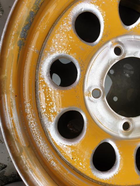

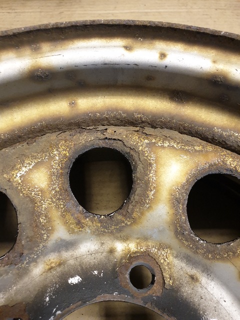

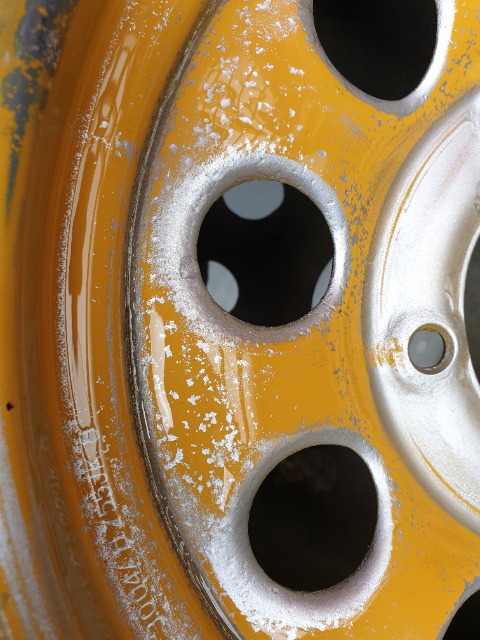

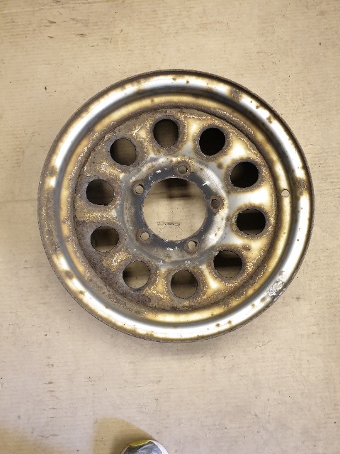

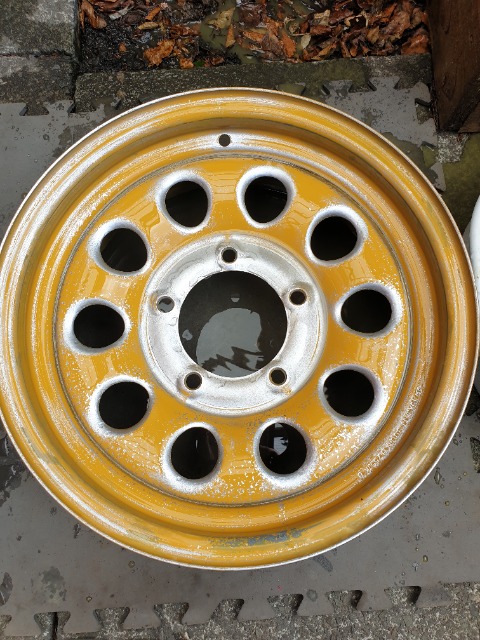

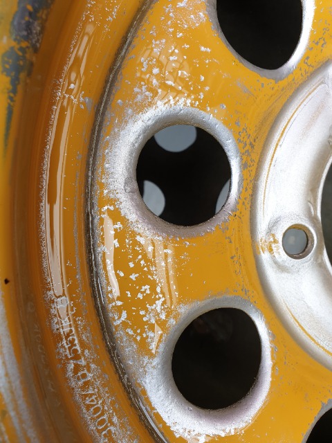

I used a wire brush, cup & flat in the angle grinder. That was good enough for the 4. The 5th need rust treatment and filler primer. I'm hoping the next rub down with wet & dry will be the last before final colour.
The yellow is the filler primer. I gave it a light dusting with silver so could see the low spots stand out. It has had another good coat of filler primer and a silver dusting. Just waiting another rub down now.
