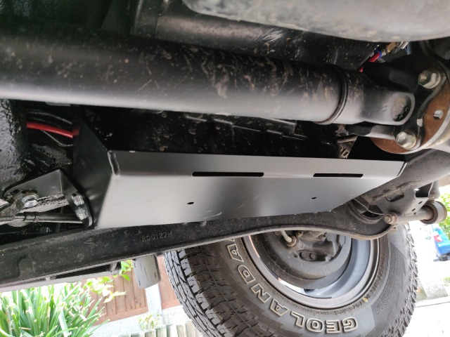

Fitted a Jimnybits fuel filter guard this morning. Nice and easy, despite me not finding the instructions until after I'd finished! Being on the skinny side, I even managed it without stands/ramps, although it was fairly snug under the car! :lol:
Impressed with the design and quality. It uses existing mounting points, so no drilling required. Two of the mounting points re-use existing bolts (12mm socket needed) with one longer replacement bolt supplied for the final mounting point (13mm socket needed).
All the delicate, low-slung plastic bits are now behind lumps of powder coated steel.

Replied by Soeley on topic Gadget's 2019 hearing aid SZ5
It's a well made bit of kit isn't it!

29 Sep 2019 10:51 #213993
by Gadget
They are! All the JB stuff seems very high quality. Thanks for the install photos on your car thread, they came in handy when I could find the instruction sheet!
Replied by Gadget on topic Gadget's 2019 hearing aid SZ5
Soeley wrote: It's a well made bit of kit isn't it!

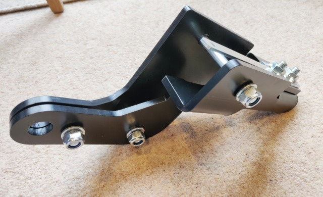

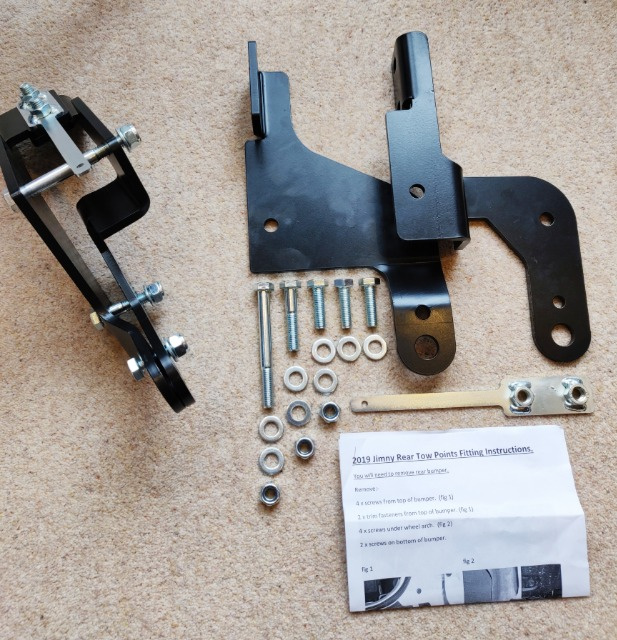

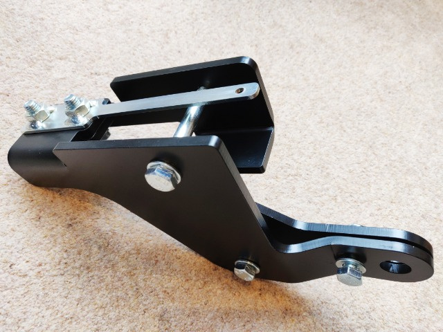

Next job if the rain ever goes away is to fit some @jimnybits rear recovery points.
Really impressed with the build quality of these again. 7mm thick steel, galvanised and powder coated. Supplied as a pair, with each clamping either side of the rear chassis rails. Towing eye is 22mm diameter.
Only downside is again weight, at 4.45kg each! I suppose I could just fit one, but the lack of symmetry might induce OCD rage :laugh:
I'm undecided on colour, should I leave them black or paint them gloss red? #firstworldproblems

29 Sep 2019 13:08 #214002
by CC Baxter
Replied by CC Baxter on topic Gadget's 2019 hearing aid SZ5
Go on, paint just the eyelet end. Red or yellow, a colour coded recovery is scientifically proven to be more satisfying.
I can't have these as I use a trailer regularly, will be buying the fronts when they show up on the site.
