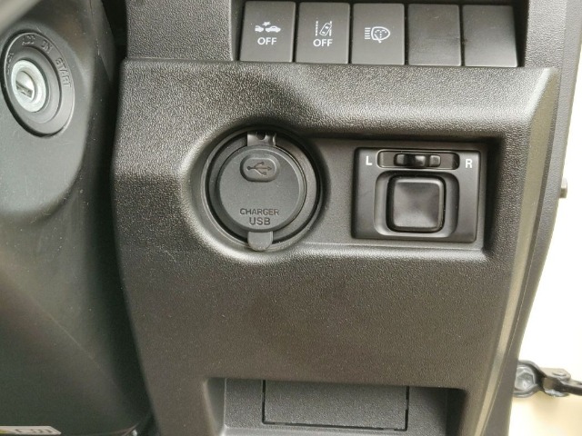

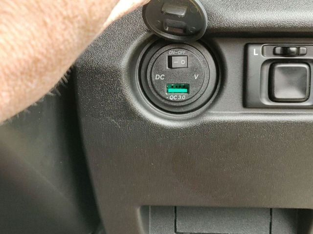

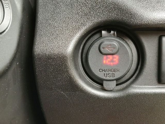

10 Apr 2020 18:28 #220905 by DAGZOOK
Gadget wrote: Fixed one of the things on my minor annoyances list. The lack of power to 12v accessory or USB sockets when the ignition is off prevents you from charging your phone when camping unless you have the car turned on.
I fitted a combined USB port/voltmeter into the blank for the JDM start button. The space could have been made for it! :)
Part used: www.amazon.co.uk/gp/product/B07F8R9F6L/r...00_s00?ie=UTF8&psc=1
Hey Gadget! quick question, how did you remove the round blank in the trim panel where you've fitted this USB voltmeter, does it just pop out? I'm looking at fitting a voltmeter here also (hardwired to the battery). They all seem to be a standard 29mm so hoping it'll fit as snug as a bug in a rug just like yours :P
10 Apr 2020 22:01 #220912 by Soeley
Yes, the blank just pops out. To fit these the blank was drilled out and the USB fitted to the blank.
The following user(s) said Thank You: Gadget
11 Apr 2020 10:12 - 11 Apr 2020 10:13 #220929 by Gadget
Thanks Soeley. What he said ^^^^^ :)
