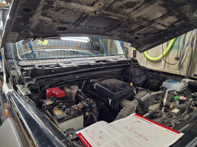

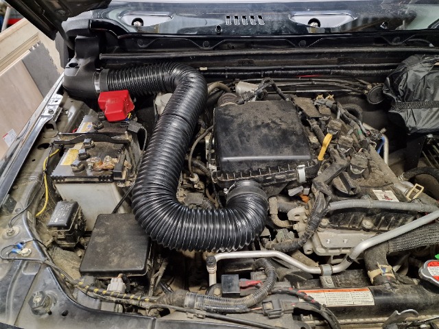

Looking good.I finally got around to fitting my Bravo Snorkel today.
It is pretty straight forward and easy, just a bit fiddly in parts (namely the scuttle end panel removal).

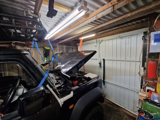

Bonnet definitely needs to come off, although I manged that on my own

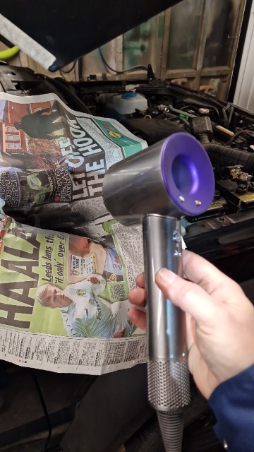

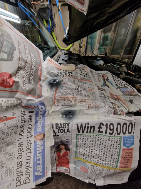

The two holes I had to drill for the riv-nuts, I sprayed with Zinc primer then a topcoat. Couldn't find my heat gun to aid drying so I borrowed the wife's Dyson hair dryer
The levitating bonnet trick worked out quite well. I drew around the hinges with a fine pencil to aide refitting.

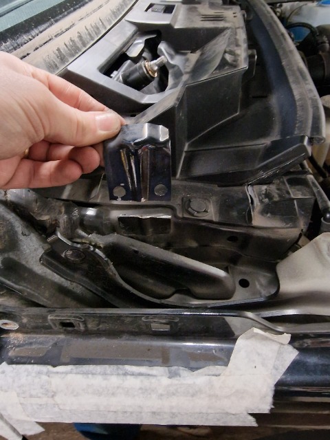

This is the bracket that has to be cut off, it does nothing, there is another on the left side that also does nothing?
Shush!
Two riv-nut holes prep'd
This bracket has to bent down out of the way, the top coat just flaked off, not sure if the primer came with it so give it a quick touch up.
I also marked the wiper arms and spindles, to ease refitting.

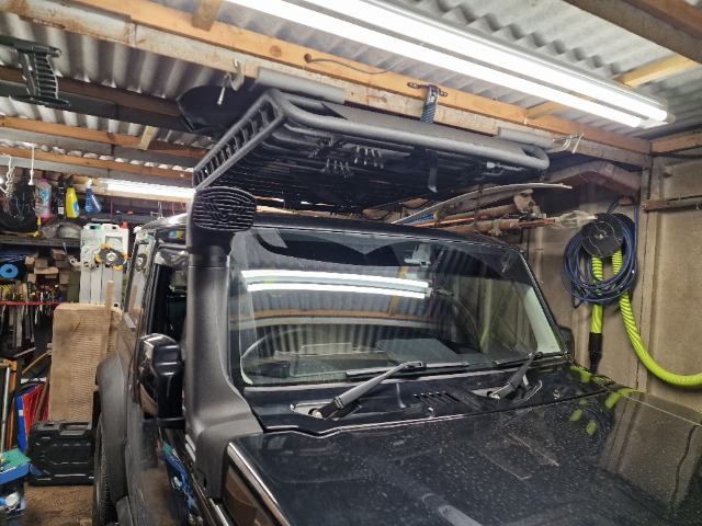

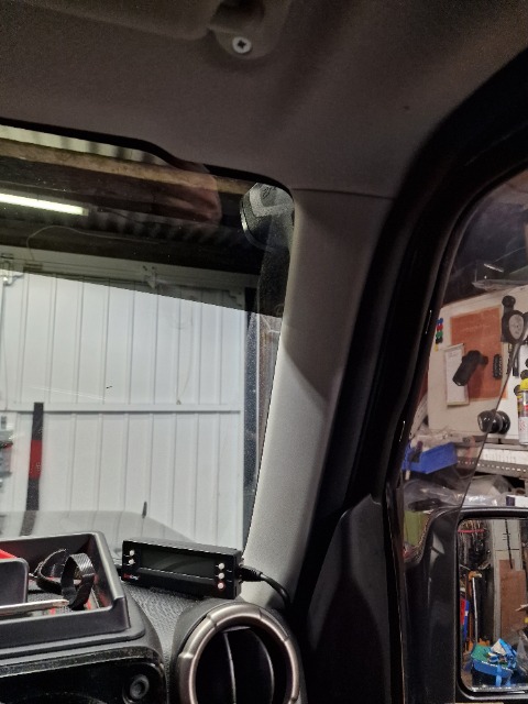

View from the drivers seat. Can hardly tell it's there.
How are you finding the snorkel? Does yours produce the same harmonic noise and vibration through the pedals?

05 Jan 2023 19:45 #246700
It is producing the noise, but I haven't really driven it much since fitting, so need to see if I can replicate it at the same revs/speed every time, before looking into it further.
Replied by Soeley on topic Soeley's 2019 Black SZ5
