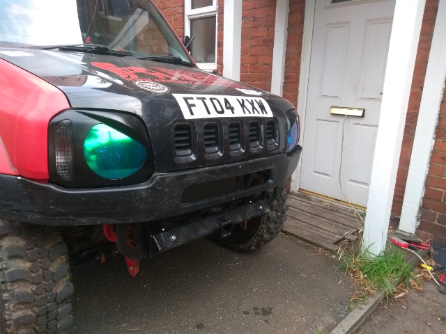

09 Aug 2020 13:53 - 09 Aug 2020 15:08 #226393
Replied by jackonlyjack on topic My Jimny
Gave him a makeover/facelift just for laughs.......it won't last long given the terrain I drive......but looks
