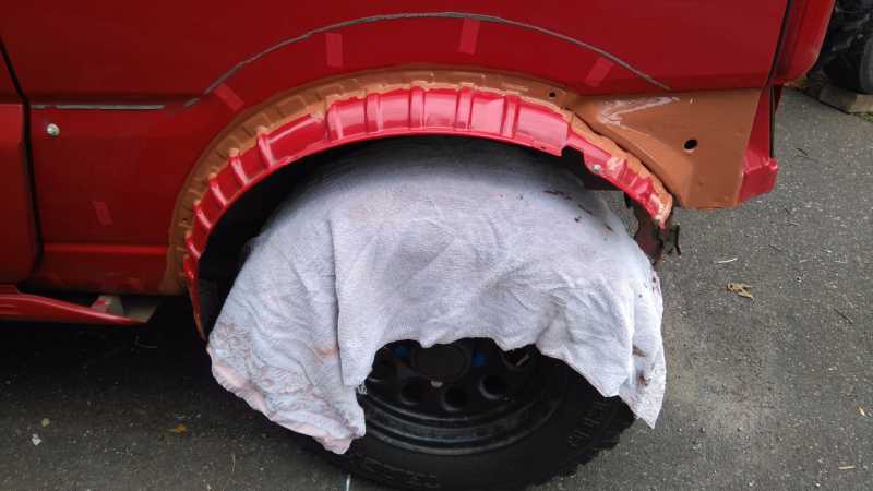

and outer arches
inner sills
must admit the rust on this jim is minimal
but prevention rather than cure
Jack

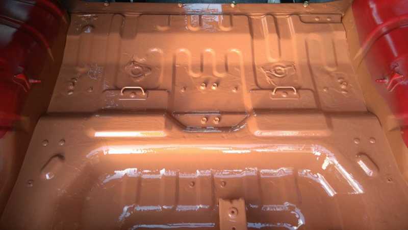

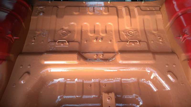

Replied by jackonlyjack on topic RCP boot floor
and outer arches
inner sills
Jack

Replied by Daniel30 on topic Red & Black Basher
Nice, it's looks like it gives it a nice even finish
Topic Author
11 Oct 2016 16:11 #173375
Jack

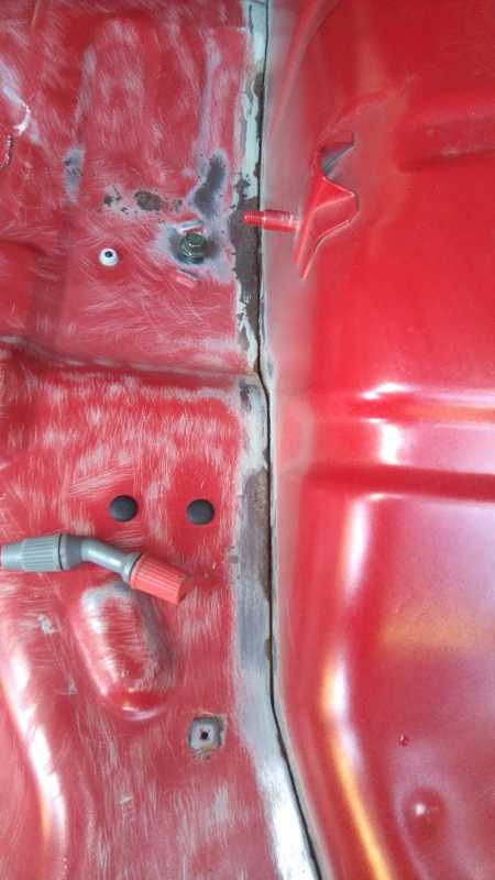

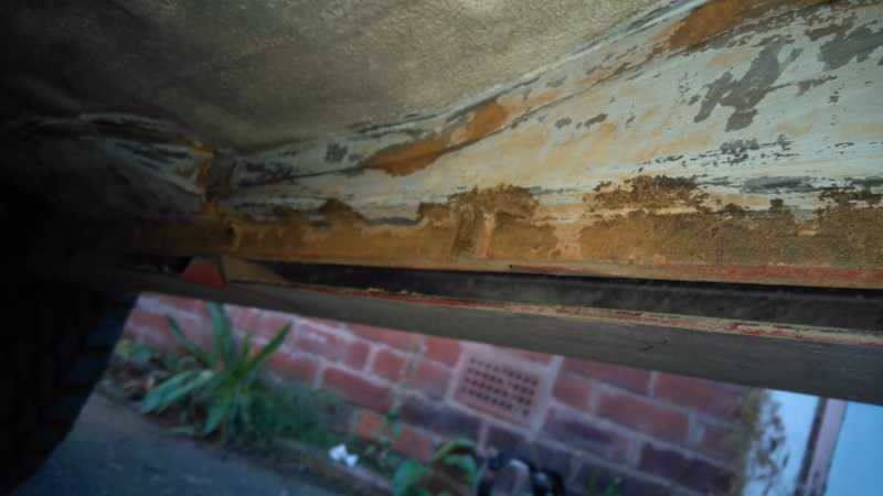

Replied by jackonlyjack on topic Red & Black Basher
yes its not bad to paint with just waiting for my CIO to arrive from themDaniel30 wrote: Nice, it's looks like it gives it a nice even finish
Jack
Topic Author
11 Oct 2016 17:21 #173380
dugout all the old seam seal before painting
also on inner sills removed factory underseal
just be aware half the rust on sill was not visible it creeps behind
the underseal :ohmy:
Jack
Jack
