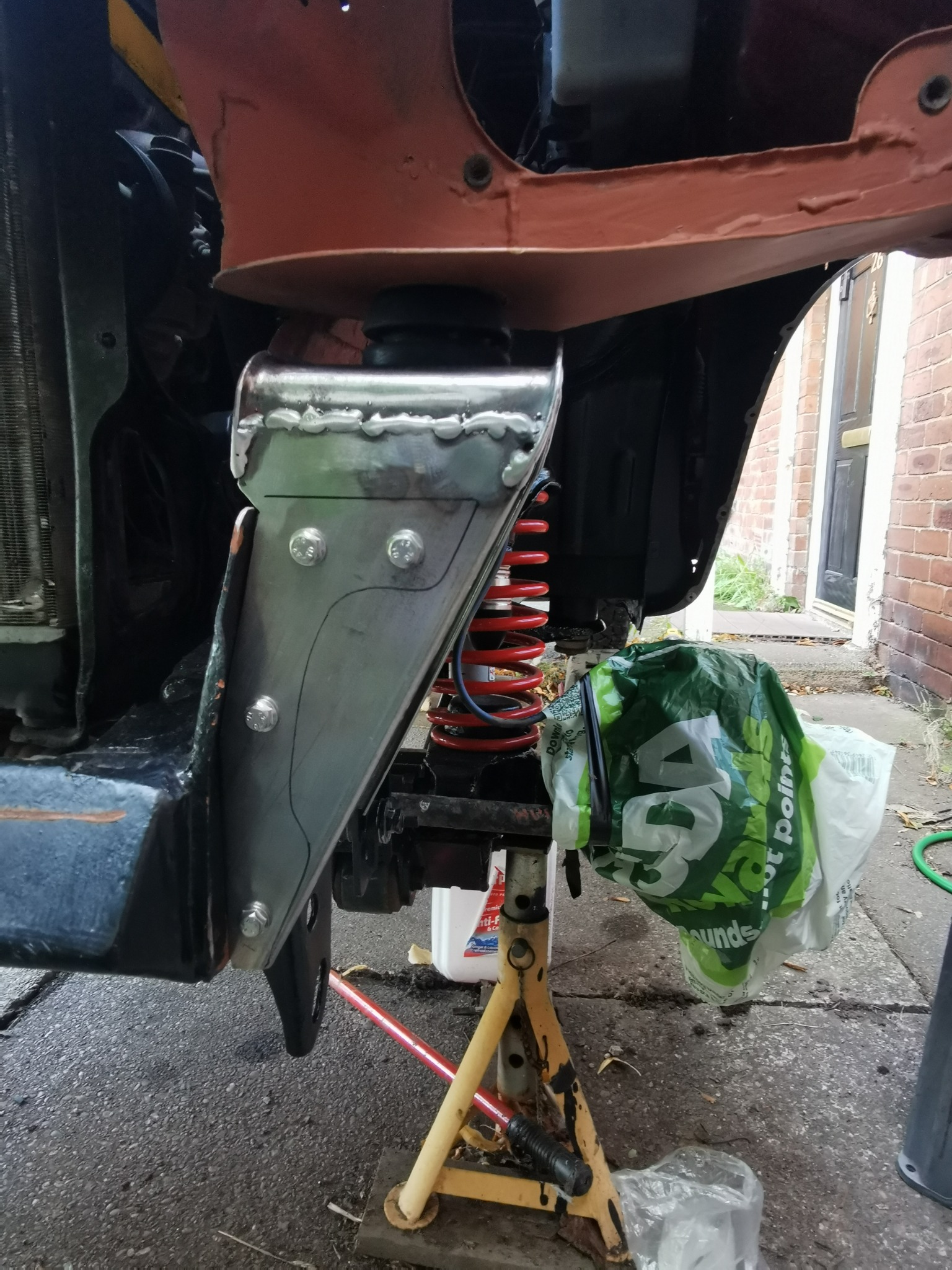

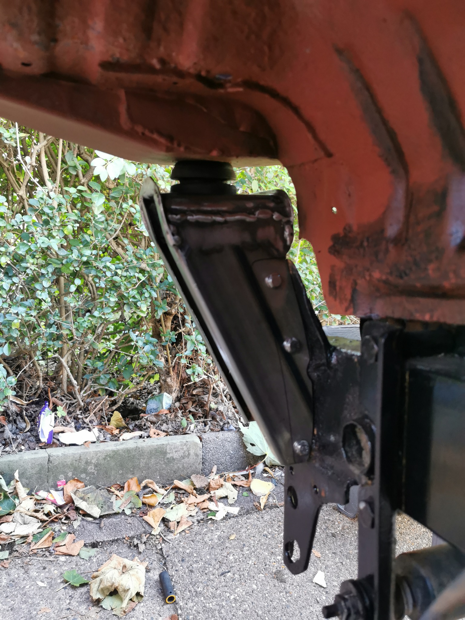

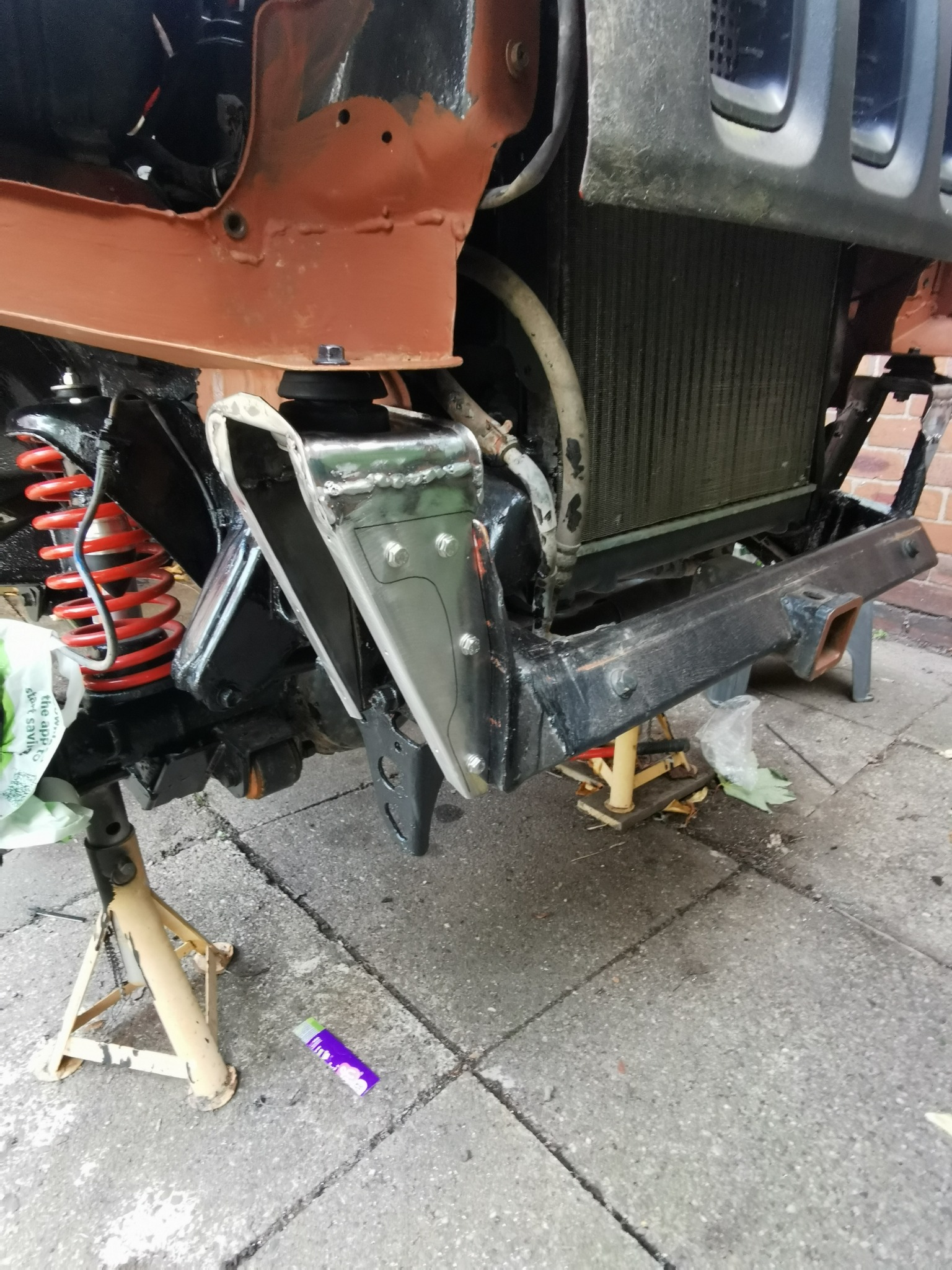

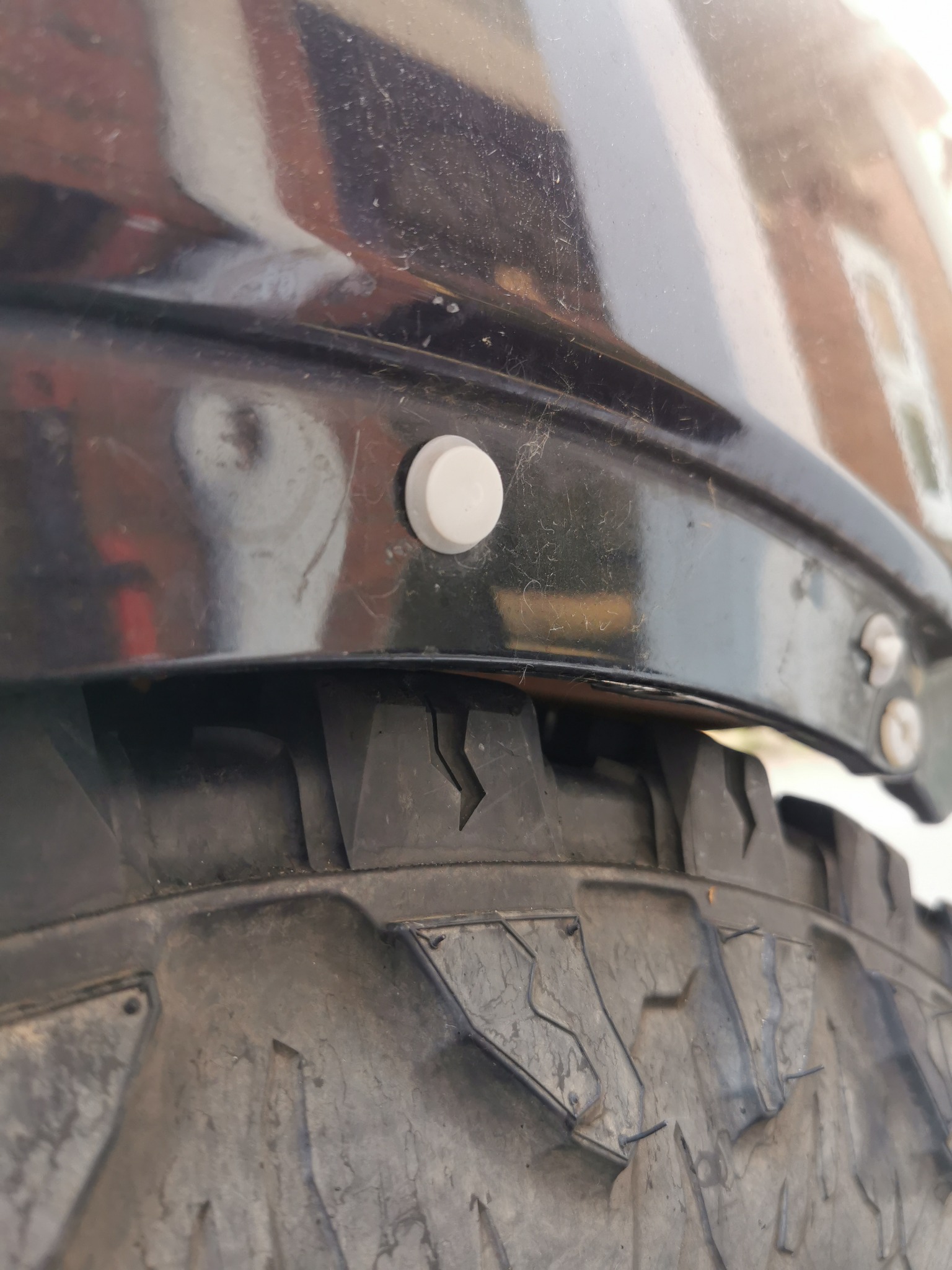

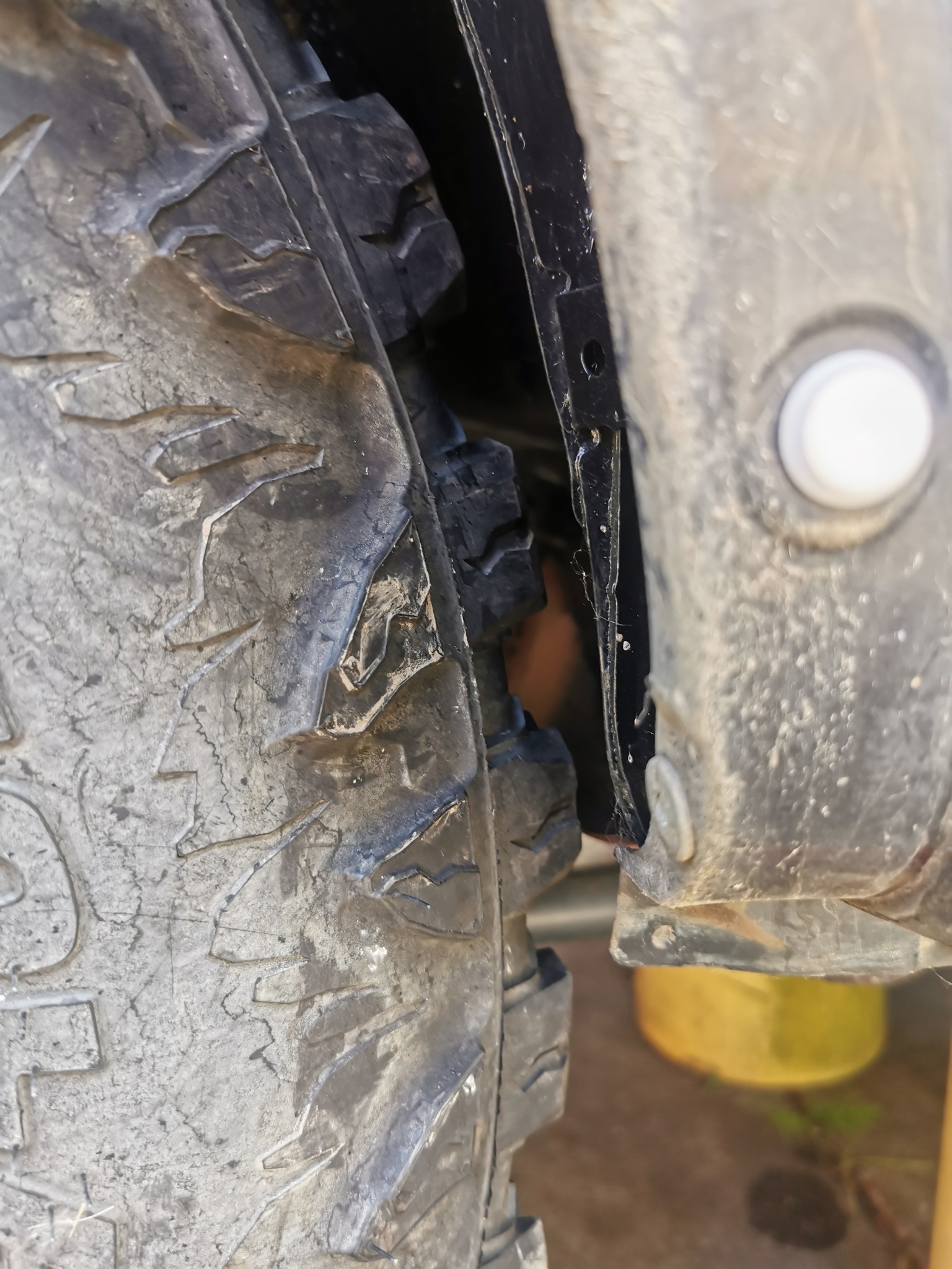

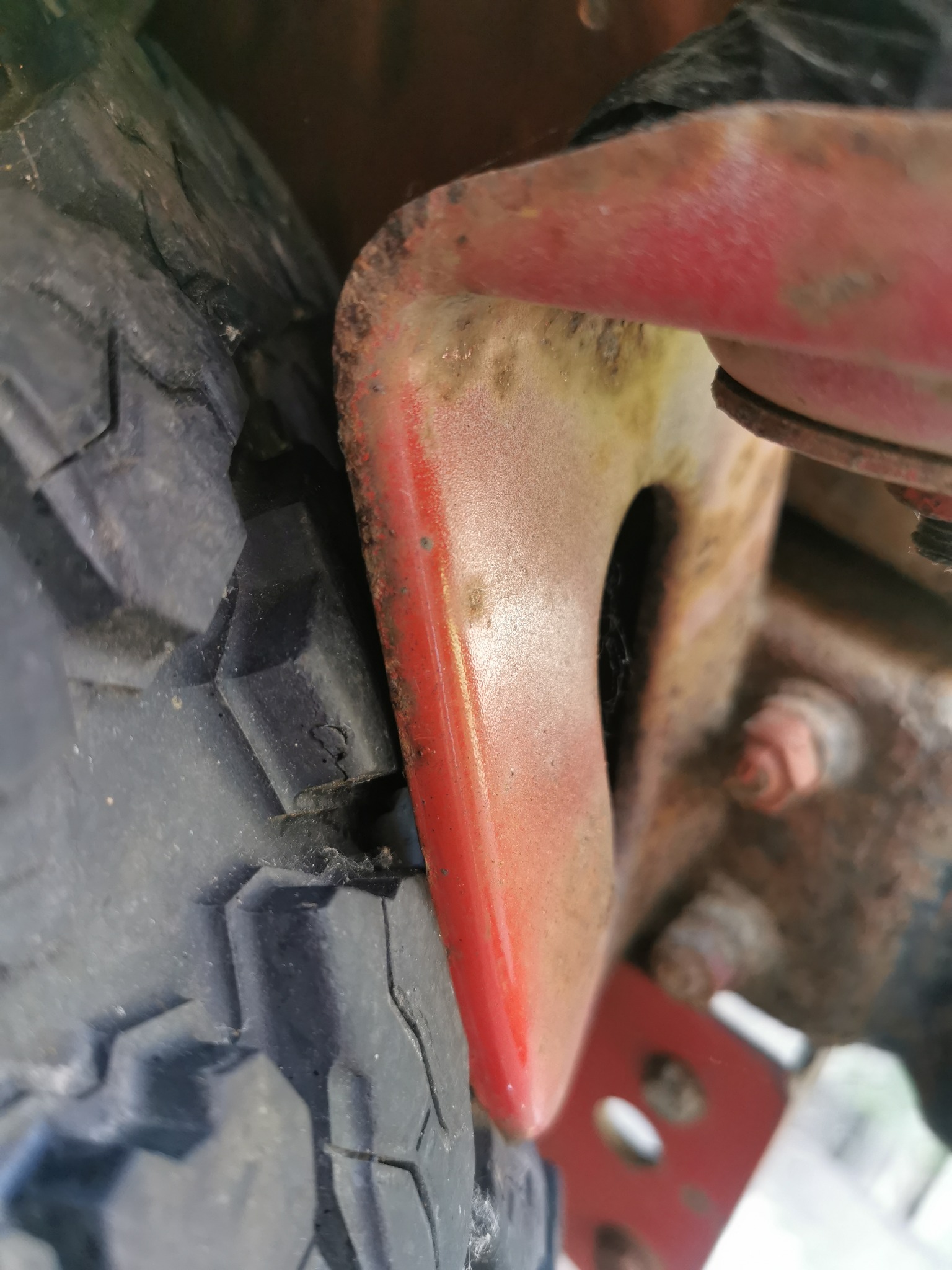

New bumpstop day for front and articulation testing with JB23 wings
Pictures taken with springs removed and hard up against the bumpstop
Just a few bits to address and happy how close it looks

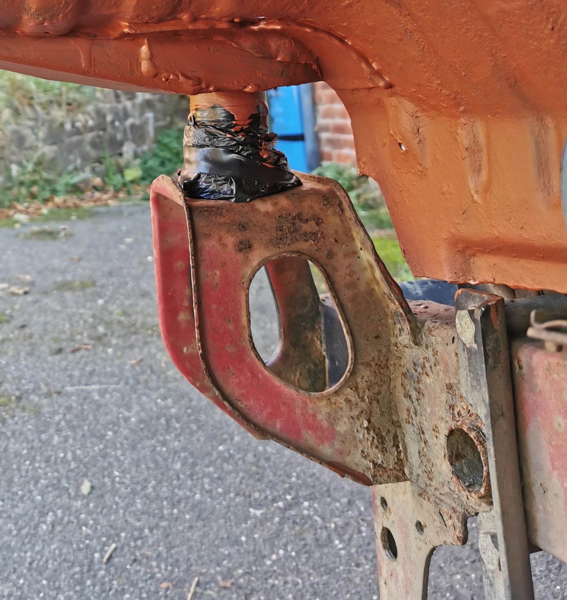

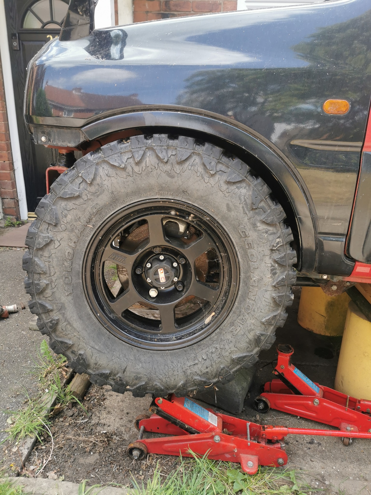

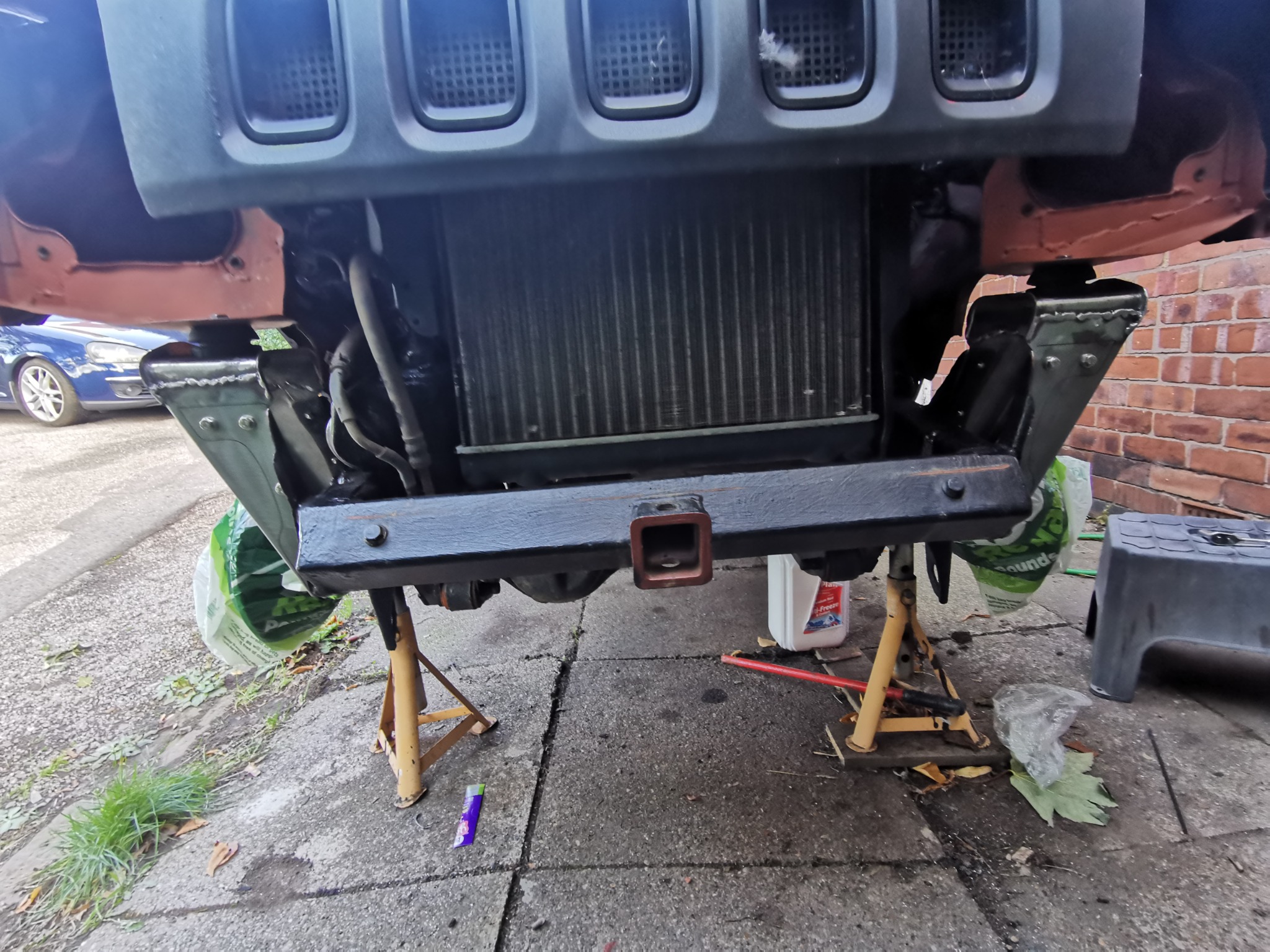

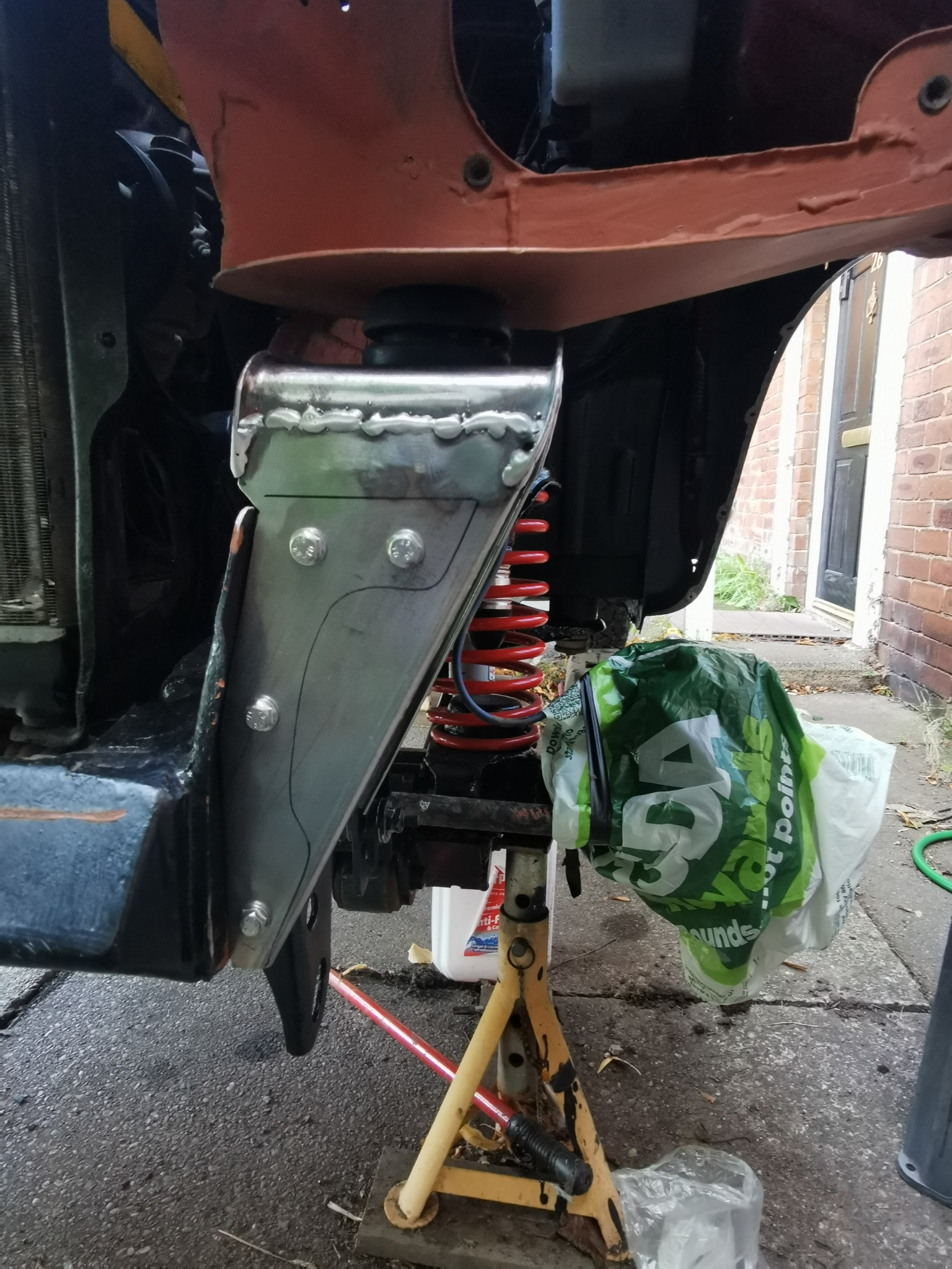

Slowly getting there with small lift and big tyres
For years I have issues with rubbing
Hopefully solved it now
And a prefer the new look
Also made them bolt on so if I need to do anymore clearance cutting it can be done easily
