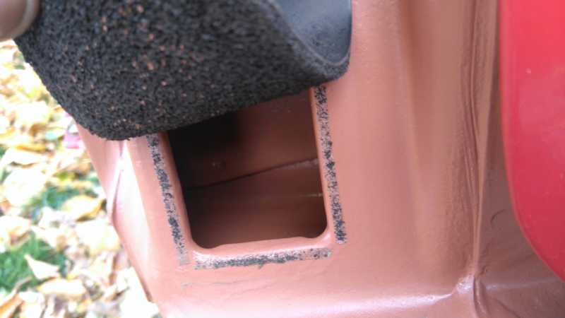

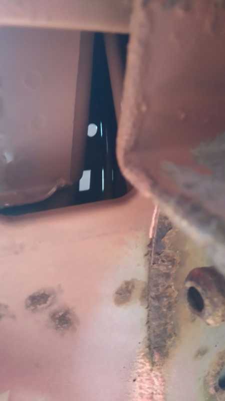

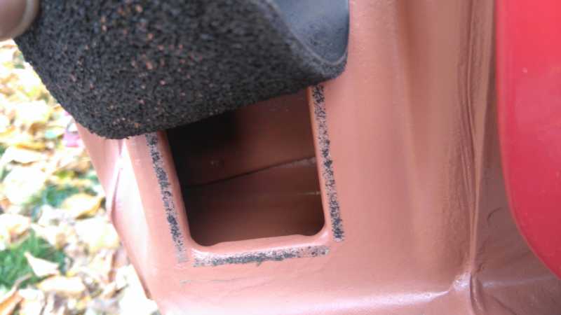

More RCPing today done all inside the rear body cavity
i did not realise there was so many places for water to ingress
till all the paint started to run out :ohmy:
Jack
Jack

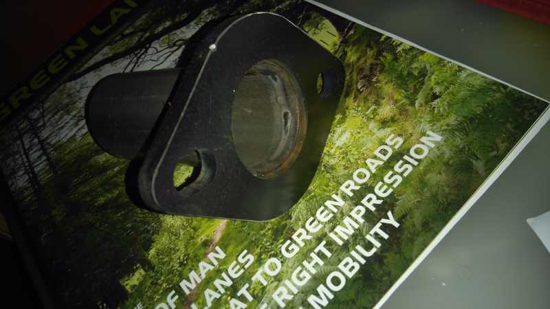

Replied by jackonlyjack on topic New back box

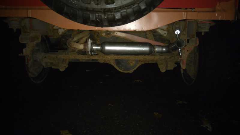

The main reason for using the savvy pipe
Is it has these on each end
I shortened it a little and already had a tight 1D 90degree bend wasn't to much of a job
Not to sure whether i like the exhaust note
it's not stupid loud
Ebay item number 291940019493
I cut the flange off bent long end
Then welded it to the short straight before the box
Other end i cut off see picture
That will be used on my next silencer if i chose to remove the one fitted
Jack

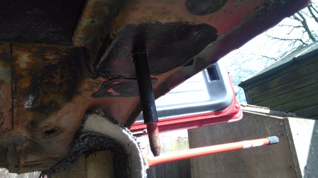

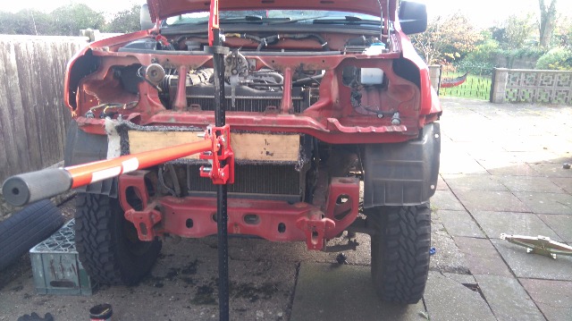

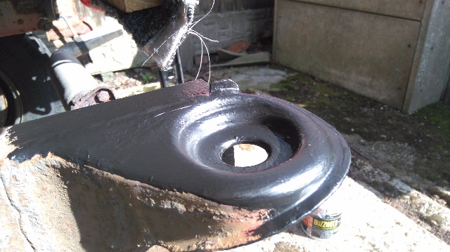

Replied by jackonlyjack on topic Transformation begins

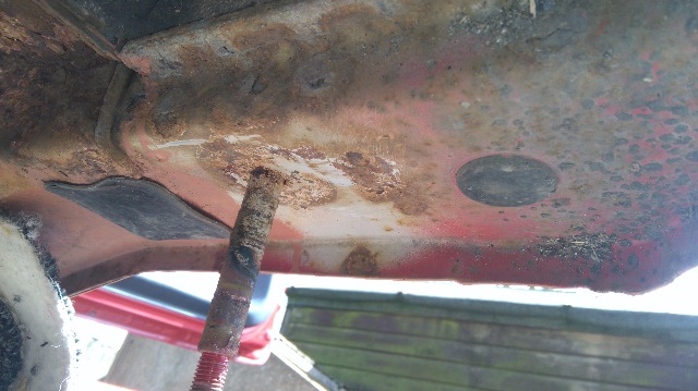

so i opted for a 1" body lift
main reason is for cleaning the under side
not leaving any trapped mud and better air flow round body mounts to dry them
body mounts have minimal rust
but gave them a scrape painted with buzzweld CIO
lifting the front was a bit un nerving (never done this before)
