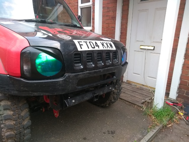

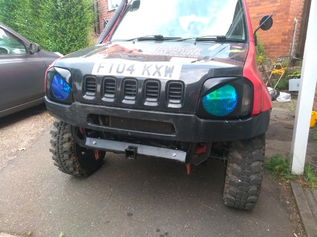

Replied by jackonlyjack on topic My Jimny
Gave him a makeover/facelift just for laughs.......it won't last long given the terrain I drive......but looks

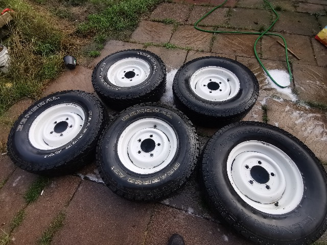

New to me landy rims 16"x5.5"
These have a +et of 33
So when adaptors are fitted it will leave me at
+3 et/offset
+3 et/offset

07 Nov 2020 17:49 #229784
Ooh that's interesting. Thanks for sharing. Off to go see what the offset is on range rover rosytles.
