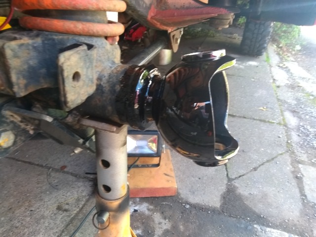

Time for front axle strip down
Paint my swivel's
Trailgear shafts n cv's
26 spline side gears
And new kingpin bearings if needed
Paint my swivel's

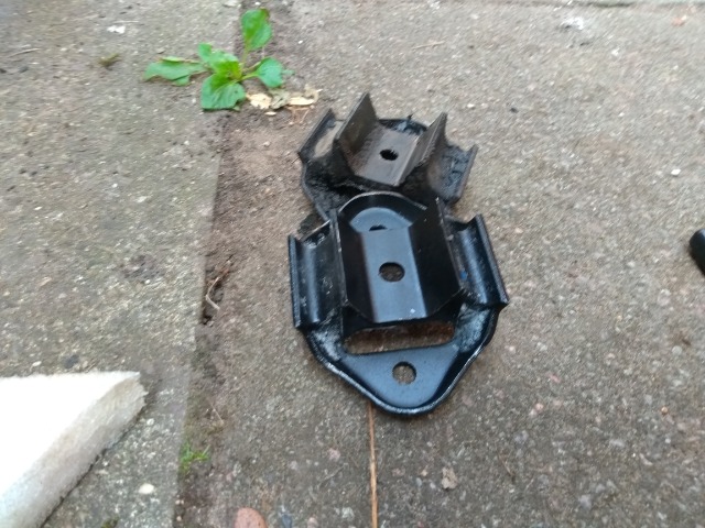

26 Jul 2020 15:06 - 07 Aug 2020 07:36 #225702
Replied by jackonlyjack on topic My Jimny named R&B
Por15 on the swivel's

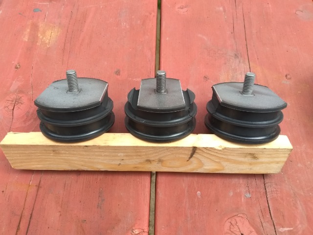

Modified landy engine mounts to fit transfer cradle

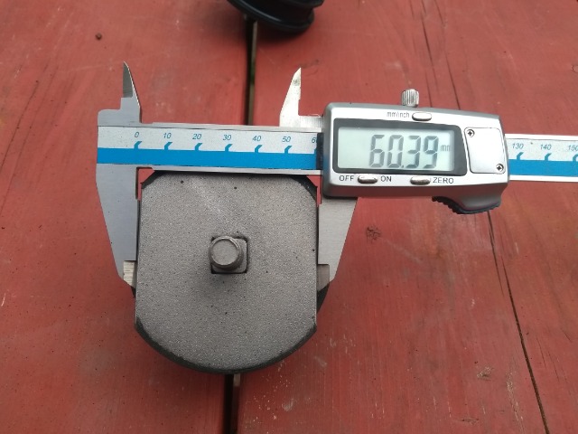

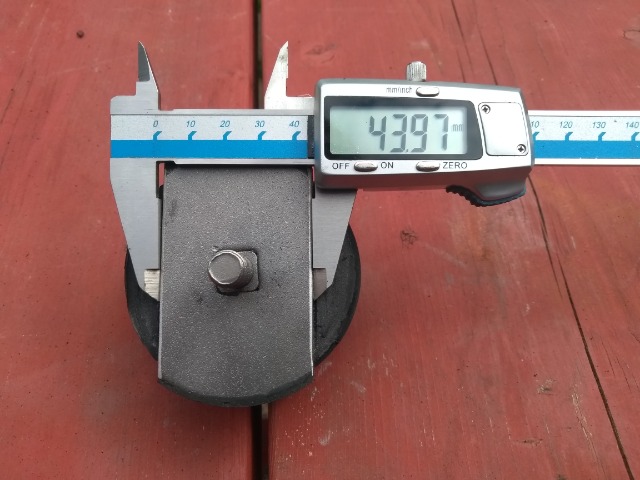

Measurements
X2 cut to fit driver side
This one cut and shaped to fit rockwatt cradle
Not sure you would need to modify for standard transfer mounts
Measurements

Topic Author
29 Jul 2020 18:20 #225831

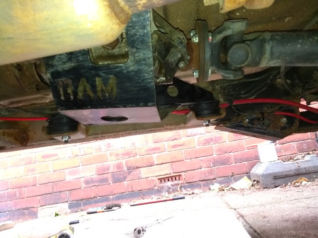

Modified bushes fitted
While i was under their had a look at rear engine mount
Central bolt looked off to oneside
So got a new one from the spares shelf
Old one not delaminated but rubber really soft

They look a good fit

Topic Author
30 Jul 2020 18:18 #225871
They do fit well Riccy
Got fed up of the bolt through one's moving to one side slightly. think that's due to the bolt through's only being M8
Landy one's are M10 so no movement to be had,the transfer is lifted around 15mm higher up now
Expecting some vibration from them....but knowing they are now super strong i can live with vibration :laugh:
