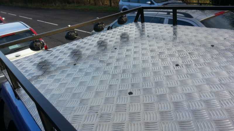

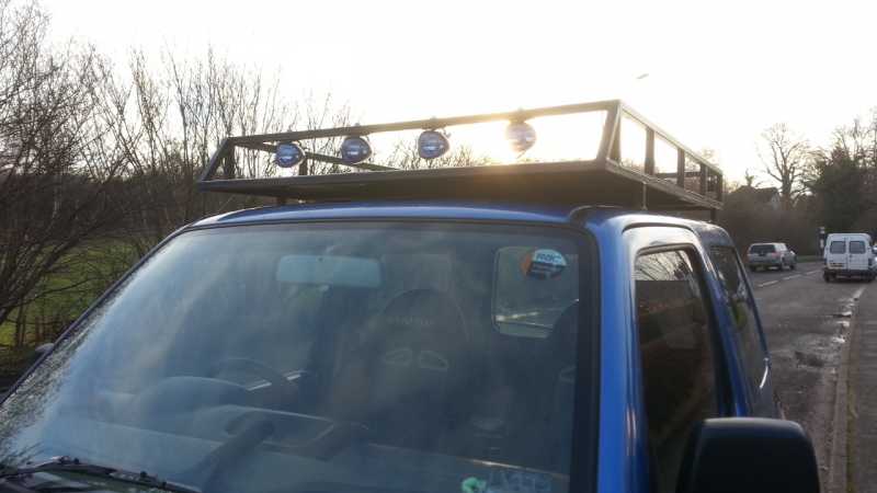

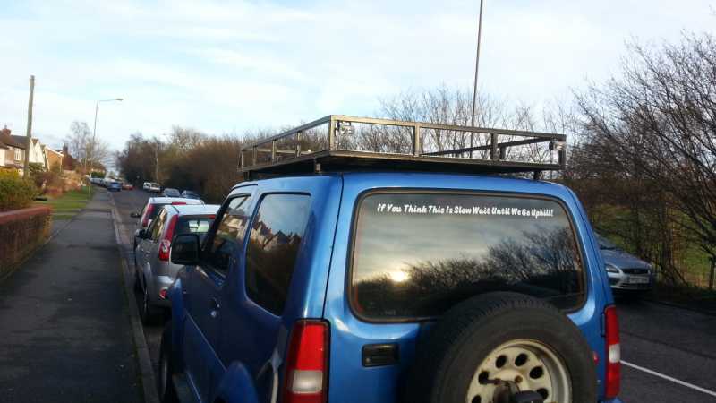

The Basic Rack was £250 inc powder coating, any bits like spotlamp tabs, CB antenna tabs and powder coated wire mesh base for the front section were extra.
It was close to £300 when fitted. Obviously its better to ask Matt at MCB for a better idea as each custom one will be a different price.
The RotoPax Fuel Tanks were £140.00 for the pair, the mount kit was £49.50 and the extension to hold both tanks was £27.50

The rack price seems really keen! Does it mount to the original mount points of the roof rails?

Vacneb wrote: The rack price seems really keen! Does it mount to the original mount points of the roof rails?
Them fuel carriers are a bit spendy though :ohmy:
Yes it mounts direct on the original roof rail mounting bolts
