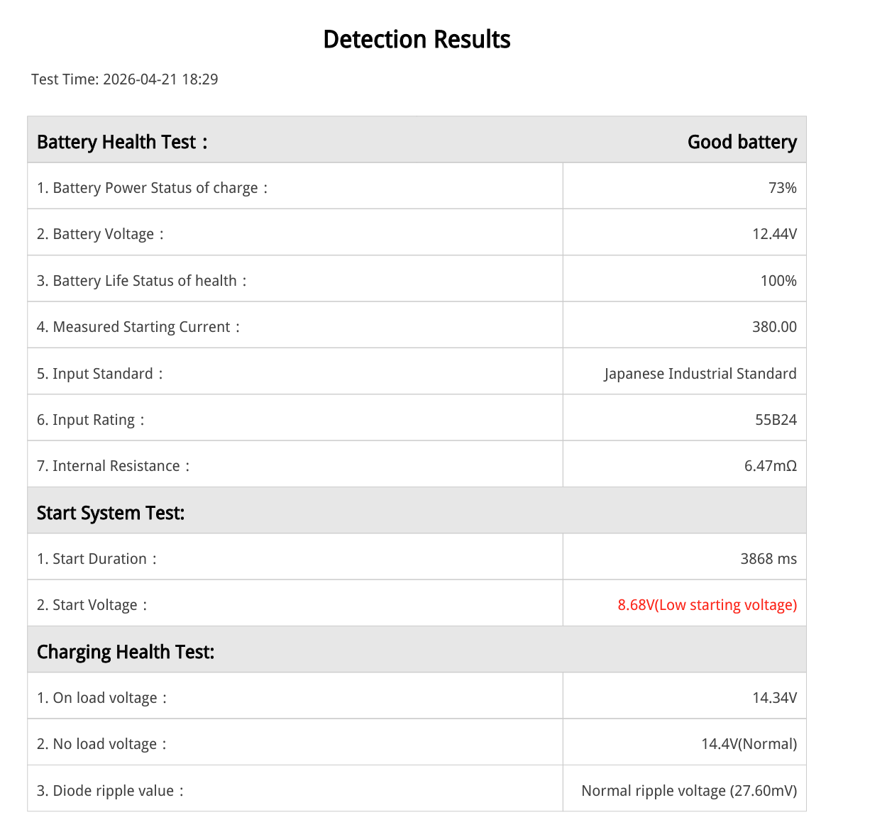

Replied by mlines on topic Jimny Diagnostics (via OBDII connection)
First results in on the battery tester. The 8.68V(Low starting voltage) is strange when compared to the other readings such as 100% healthy battery

Replied by Lambert on topic Jimny Diagnostics (via OBDII connection)
That's broadly what I got the toyota on an unhealthy battery it has occurred that the level of charge is directly related to the starting voltage, because with a 95% plus charge on temeraire the starting voltage was like 12.0 and everything was happy. I have however changed the battery on the toyota to a healthy one I just haven't got round to retest it yet.
