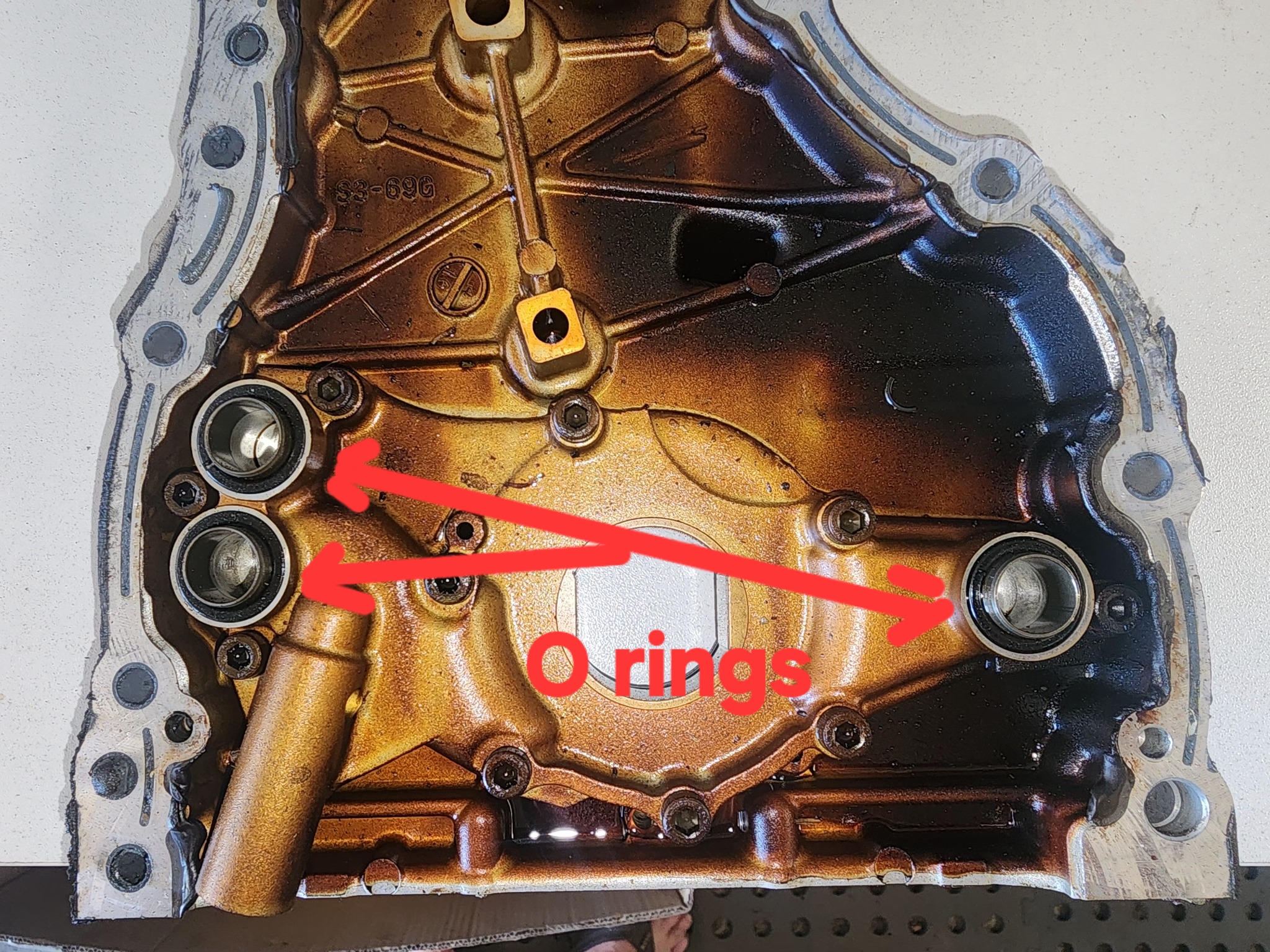

Also been searching my manual for the name of 3 O ring seals on the timing chain cover.
can anyone assist pls, as at least 1 is split.

27 Feb 2026 10:43 - 27 Feb 2026 10:45 #263904 by fordem
09280-17002 - O-ring - I would just measure one and find a generic replacement.  If you need a name I would describe it as an oil pump O-ring, it's shown on the oil pump page of the parts manual.
