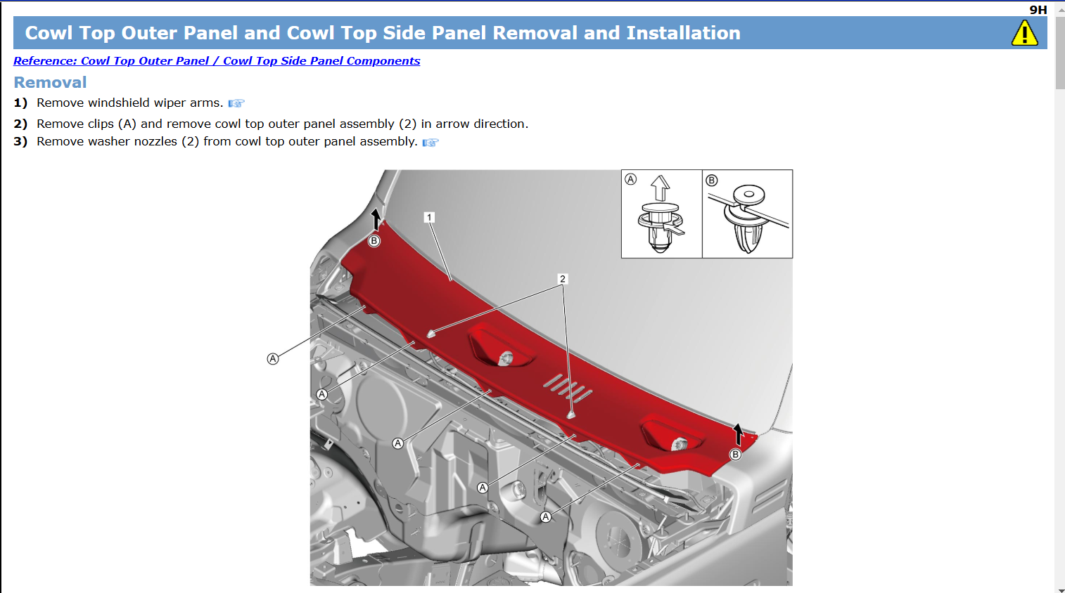

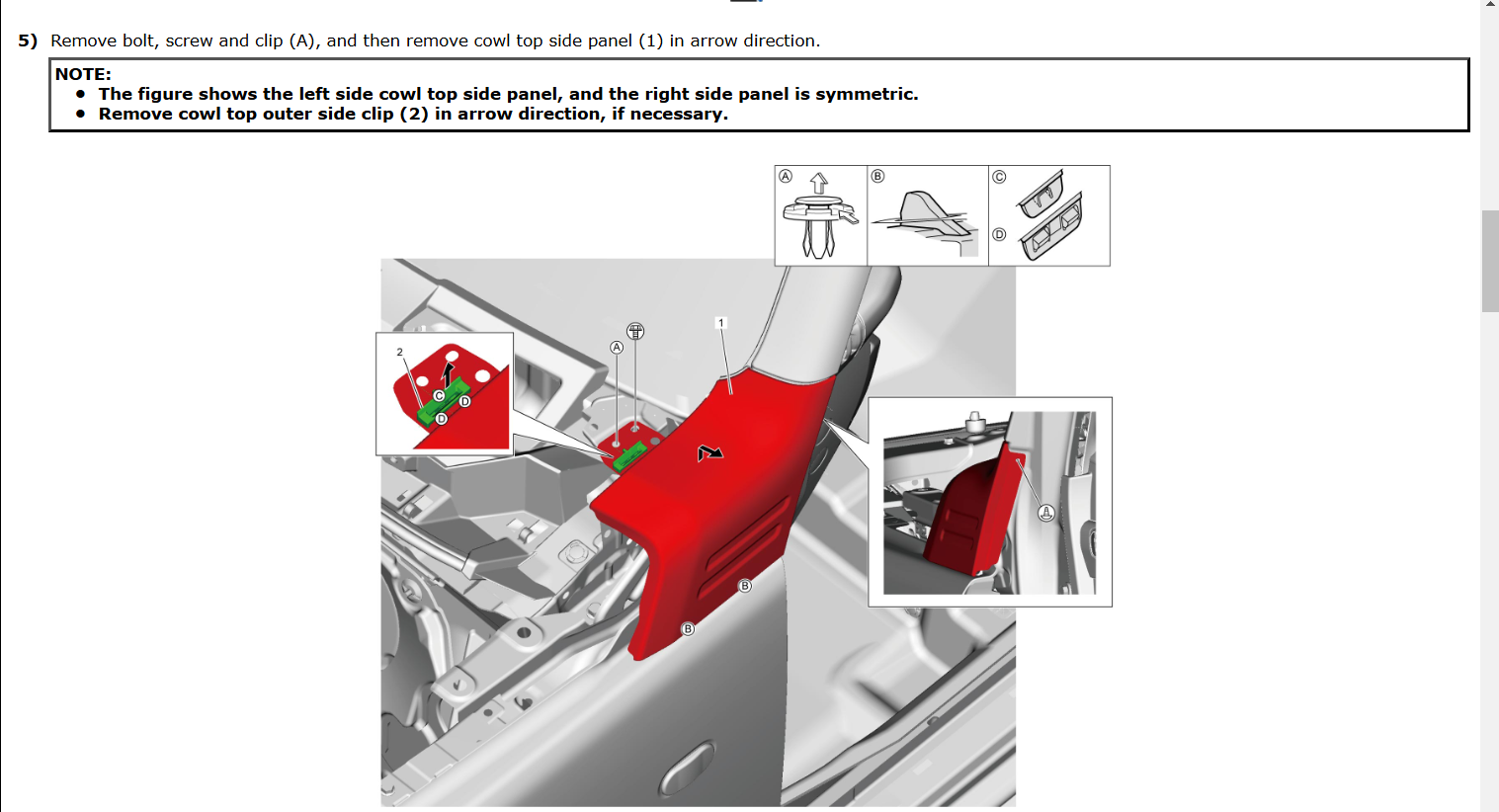

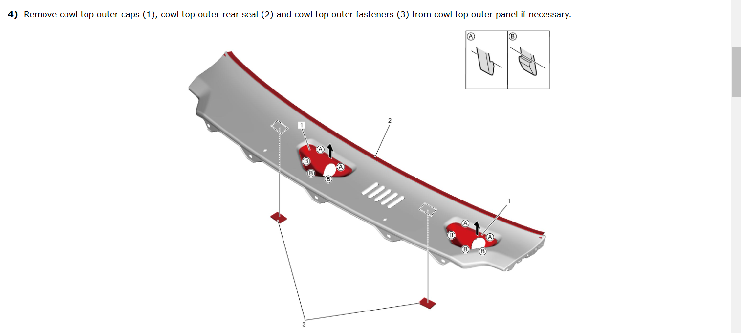

I'm sure my Bravo snorkel came with the instructions, but this is from the WS manual.

Remove wiper arms, remove bonnet, undo clips on leading edge (the middle pops out, flat ended screw driver does the job). Then yank up at each end to release the friction clips.
