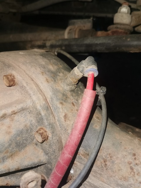

Is the black seal in Diff removed when fitting the breather?
31 Dec 2024 08:25 #258912
Replied by jackonlyjack on topic Diff breather manifold required?
I fitted these 8 years ago and never had an hose disconnect
It's a 1/8 bsp elbow to 6mm od pipe
Removed the cap and tapped the stub 1/8th bsp taper tap no drilling needed
Just used grease and a strong magnet on the tap so swarf stayed on the tap
