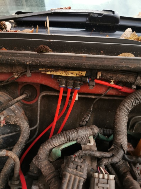

Given that the breather valves on the diff etc are open ended, can someone explain why a manifold is needed on the end of the breather tubes? For a cheaper solution couldnt the hoses be terminated in anything that prevents water splashing into hose?
Can breather tubes etc ever make things worse, such as if a hose disconnected, or got water in it? I assume the factory valves are designed to prevent water build up at the opening, hence reducing the risk or water being drawn in when pressure drops.

To your first question, the manifold is not needed at all.
A lot of 4x4ers just use a length of hose, a small-engine type fuel filter, and a couple of jubilee clips or the equivalent to hold it together. The only reason to get a fancy manifold setup is if you are one of those nerds who likes festooning his Jimny with branded accessories. (Nobody like that here on the forum of course.)
As to the other question, yeah, if the hose came adrift that would be a problem. If you install remote diff breathers, make vent hose checks part of your PMs.

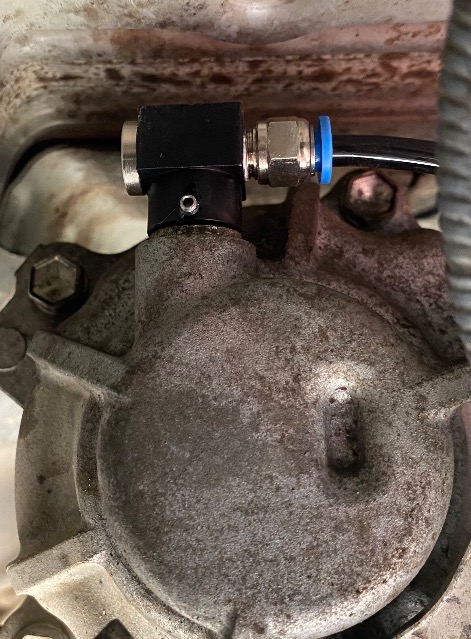

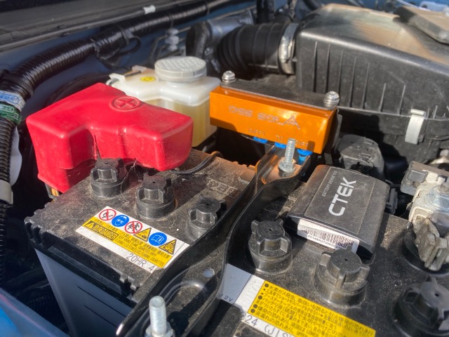

I fitted the Des Sol diff and TC breather kit to my Gen4 and yes it does feature a fancy manifold
However, the reason for fitting wasn’t the manifold but the quality of the fittings used to clamp over the existing breathers, which feature 90 degree pipe fitting, o-ring seal and 2x grub screw. The clamps also feature spring loaded push fit pipe clamps which are easy to use and provide a perfect seal on the tube, whilst allowing for easy repositioning. They were very solid when fitted and I checked them after a few outings through water and hadn’t moved.
The transfer case breather would be very hard to fit without a 90 degree fitting as shown in the following photo
The Des Sol kit isn’t cheap, it’s about £100 in the UK, then with shipping, import duty and VAT they are about £150 and as Motacilla points out there are lots of lower cost options out there, but I was impressed with the breather clamps and the very clear step by step instructions.
