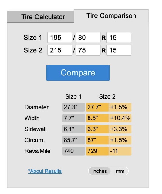

@ fordem
I cant see that detail on the Kumho site
www.kumho.com.au/tyres/4x4/at52/
looking at 215/75r15

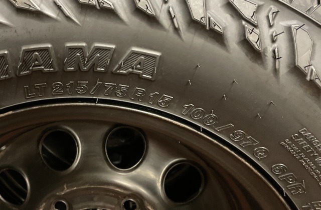

Take a look, judge for yourself, We don't get much rain, but when we do, these are to be driven wisely.
Otherwise they're the real McCoy.
www.yokohamatire.com/tires/geolandar-m-t-g003
