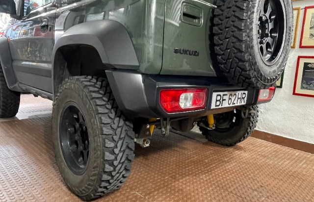

23 Aug 2024 00:24 - 23 Aug 2024 00:29 #257292
by Filipao
Replied by Filipao on topic Wider tyres on stock rims new Jimny
Last edit: 23 Aug 2024 00:29 by Filipao.
23 Aug 2024 01:27 - 23 Aug 2024 01:29 #257293
by Chicken
Replied by Chicken on topic Wider tyres on stock rims new Jimny
Nice what tyres are those ? Although they dont look like stock Alloys
