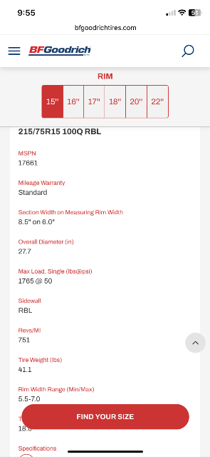

As the others have said. 215/75R15 tires fit on the standard rims just fine. I've got BFG KM3s fitted to my 3 Jimnys.

The main BFG site is good at showing tyre and rim data. Although being the USA site it lacks the smaller sizes offered. But you can clearly see they say a 5.5 rim is fine for the size you are looking at.
Replied by 300bhpton on topic Wider tyres on stock rims new Jimny
Tyre height and to some extent construction can also vary the recommended rim widths not just the section width. A bigger sidewall will normally allow a more narrow rim.Hmm I've been searching the Web and a lot of sites have size guides that seem to indicate that 5.5 inch rims Max tyre width is 195 which is what comes on the stock model. I know that people do put wider tyres on but just trying to clarify
Thanks for your answer though
Just reading through your jimny build thread, it sounds like you have 215s on stock rims and suspension. And have driven some highway and off road without trouble. Good to know I guess. Still confused by the various tables I've seen online with 195 being the supposed Max width for 5.5 rims.
