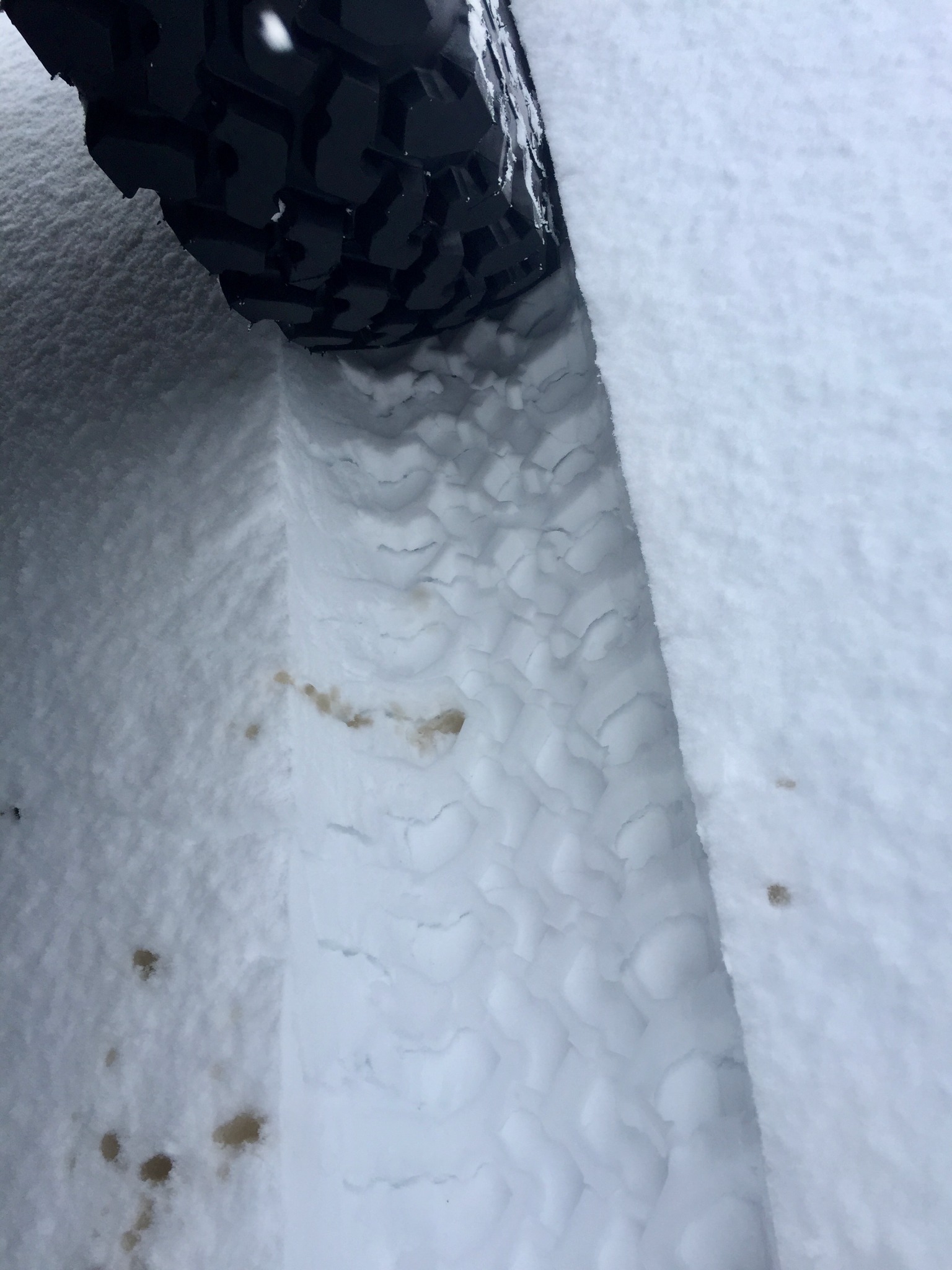

In cold parts of the World, like where you are it may be true. However, in places like the UK an MT can work brilliantly in the snow.
We tend to only get snow occasionally and some parts of the UK may go a number of years without any snow. When it snows it comes down quickly, is fresh, but often is gone completely within a few hours to max a day or so. It never gets frosted or compacted or another layer of snow on top really. Certainly not in many parts of the country.
We also get 2 different types of snow, depending on if it comes from the North, which is usually a dry snow and often like polystyrene beads. Or if is rain from the South coming up from France and hitting cold air, producing much wetter snow. The Southern half of the country the wetter snow is more common.
Through experience of driving many MT shod vehicles and AT ones, is that the MT's work way better in this kind of fresh wet snow. The lugs dig in lovely and massively enhance traction, while an AT like on mud, will slide more so and not bite as well into the snow.
Other benefits of MTs are, that the ground is often wet and muddy under the snow. So if you need to drive up a bank, verge or across a snow covered field. Should you break through the snow, the MT will give way more traction than an AT on the underlying ground.
You can see here how in this type of snow how well the MT bites into the snow. An AT tends to float somewhat more.
If the snow is heavily compacted, frosted or driving on ice it might well be a different story, but local snowy conditions covering a huge populace of UK, MTs would work very very well in the snow.
Replied by 300bhpton on topic Has anyone upgraded gen 4 tyres without going bigger?
They are 3 Peak Rated, so should be fine in many wintery conditions and certainly pass certain official tests to be counted as an approved tyre for winter use.The BFG AT is not a winter tyre
I think this is very geographically dependant.I would strongly recommend not to use MT's in any winter conditions.
