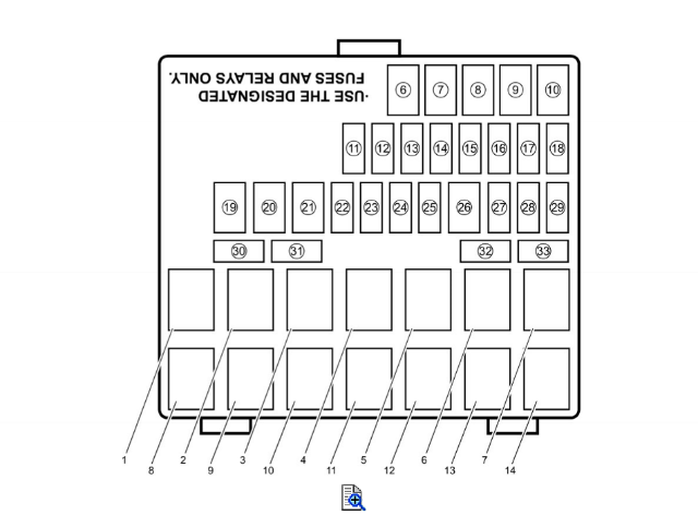

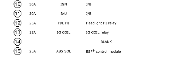

I did try to replicate you fault lights by pulling fuse 15 above, but that gave more lights than you had on, including Engine & TPMS amongst others. When I put the fuse back in the TPMS fault cleared within a few yards of driving, but I had to use the SZ Viewer app to clear the Engine light. The code was "Engine lost communication with ABS/ESP control module".

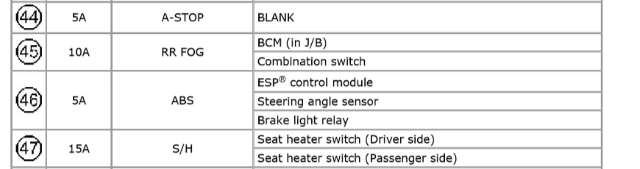

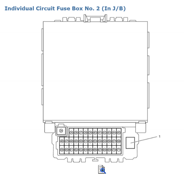

The other fuse i thought of trying is #46
The circuits it covers looks like it covers your fault lights?
