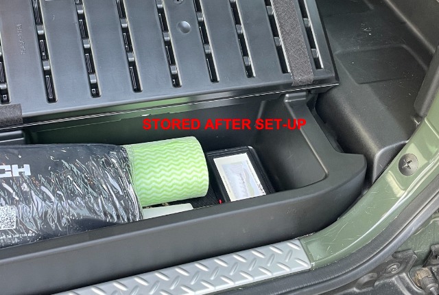

If you're still having trouble just get the Iron Gates spooftpms box.
I've been running my JB74 without any sensors for the last 6 months without any issues, it's brilliant.
