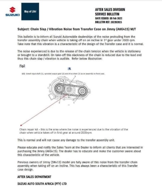

I seem to be missing something here! If a part is manufactured and subsequently shows itself to be defective then an honourable manufacturer will modify the parts and supply a kit to modify/rectify cars that show symptoms of the fault and will then fit the modified parts to subsequently manufactured vehicles.
Why then are cars, built long after this fault became known, showing the same symptoms?

If Suzuki are claiming that the noise is normal, why is there a bulletin on the subject plus a kit of parts to rectify - hopefully - the problem. When I bought my Gen.4 I was not informed of a noise that may or may not originate from the T-box so maybe that will answer your comment as to why I used the word "honourable" and yes I did note that the comments that have been referred to originate from South Africa.

Suzuki treats different markets differently, as an example, you'll see recalls in one market and not in another, TSBs (Technical Service Bulletins) in one market, but not in another, the dealership is not going to notify you of a noise that is the subject of a TSB, unless it becomes a recall.
The purpose of the TSB is to inform the dealership that Suzuki is aware of a problem affecting a given model, along with the correct procedure to rectify the problem IF a customer comes in complaining about it. Not all vehicles will have the problem, and there is nothing to be achieved by alerting a new owner to a problem that his car may not have, it doesn't inspire confidence in the brand, you wait until he complains.
The TSB concerning this chain issue has a 2019 date, my 2021 has the problem, I've driven other JB74s that don't, I suspect the problem is more likely to be present on manual transmission models as I suspect it is caused by the sudden application of torque which the torque converter on the automatic will cushion.
