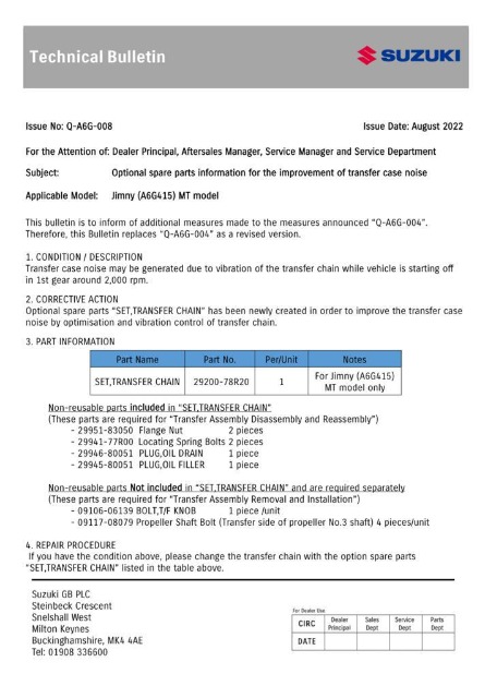

02 Dec 2023 19:31 #252590
by Filipao
Replied by Filipao on topic That super short grinding noise in first gear...
13 Feb 2024 06:16 #254257
by Alynn
Replied by Alynn on topic That super short grinding noise in first gear...
It's the rear drum brakes letting go from the auto hill hold. Use the handbrake, and you'll notice there is no noise.
22 Feb 2024 15:27 #254511
by fordem
Ummmm - I can "re-create" the noise at will, on a flat surface (so brakes and no hill hold involved) - PLUS - if you hold the transfer case lever you can FEEL the vibration.
Maybe your noise is different to mine, but mine is definitely not the rear brakes.
Replied by fordem on topic That super short grinding noise in first gear...
