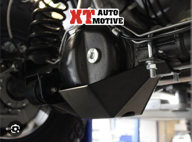

24 Oct 2023 18:49 #251719 by Busta
Replied by Busta on topic Suspension advice.
Many of the bolt-on options available for the Jimny are substantial fabricated items that reduce clearance by much more than a few mm, and have a much bigger frontal area too compared to a smooth rounded diff housing.

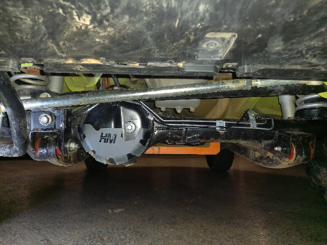

25 Oct 2023 19:18 #251737 by giacomom
Replied by giacomom on topic Suspension advice.
this is what is needed to protect the front differential and not lose ground clearance
