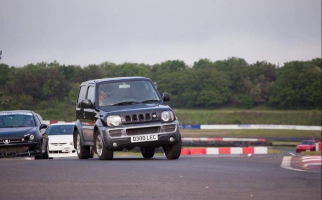

11 Aug 2023 03:28 #250216
Replied by Lambert on topic Gen4 offroad modification
As someone who has done track days in a Jimny I have to say that from experience a Jimny will understeer before tipping and that is going way way harder than you ever would on the street.
