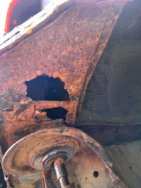

I thought I would give an update to how this went.
The problem I started out with is shown in the picture below.
Unfortunately, after picking away on the other side I managed to poke a hole with a screwdriver, so both sides were shot.

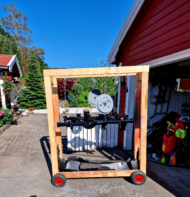

Here I have removed all in the back. Taken off the rear axle and the tank, sandblasted the rear underside:

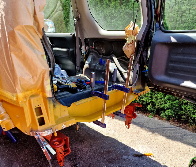

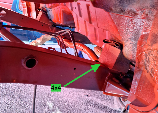

I put a piece of 4x4 between the frame and the body on each side to get it high enough to work with:

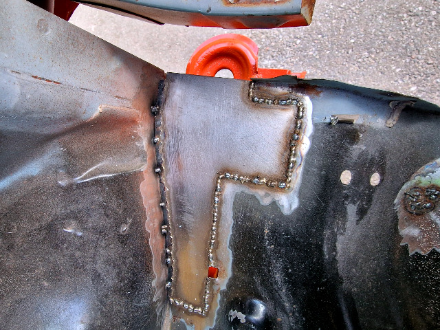

Here I put in the rear tailmember. It was a very good fit. Fitting those new parts were actually not difficult.

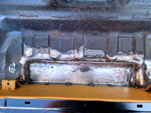

Then I also got some surprises. In the right back corner I found a hole in the floor under the "extension, back corner". It was not visible until I had removed this piece. After I sandblasted the underside I found a larger are to be rusted extremely thin, so I had to cut out a piece and weld it in.
This piece was a bit difficult to make as it has a lip on it, like the original floor, where it's spot welded. I had to make it from two pieces, the profiled top plate, then cut a small strip and form it to the top plate and weld those two together, if that makes any sense.

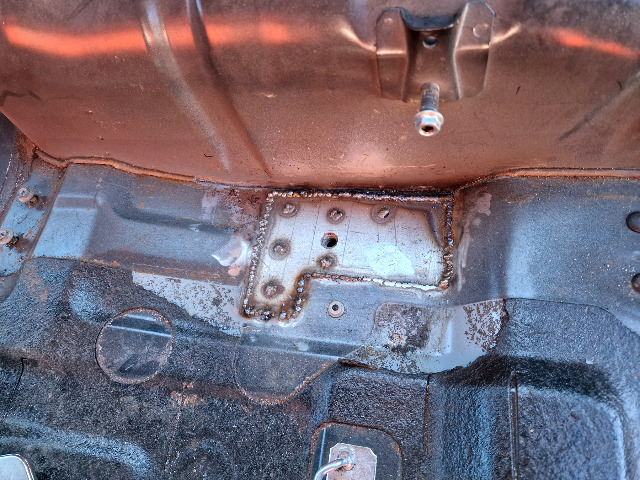

As I scraped away the seam sealer along the floor I found another area that was unacceptable, so I cut out a piece that took care of it all:
Now I was pretty tired of rust. I went over the whole rear, and found a couple of more small places that had to be fixed, but as far as I can see, I got them all.

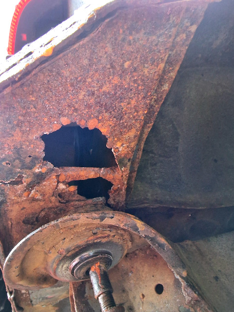

This is just what I have been doing the last days. the same place on the car except my car was not as rusted as yours, Mine is a 2005. Looks like it started in the same places. only my right corner needed weding (now).

Your welding looks good. Not too much heat into the next sheets it seems and strong. Mine do not look as good all the time, I find the correct setting on my welder when I am done I guess.

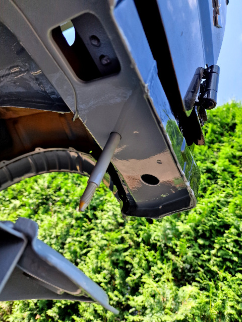

The original problem is now taken care of and replaced with new parts. No more rusted body mounts:

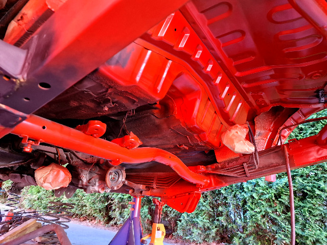

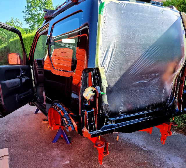

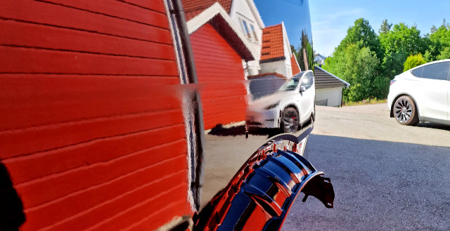

It's back together and with a good backyard coat of paint. I did use 2K epoxy and a couple of cans of the original paint code, and 2K high gloss topcoat, perhaps a bit too glossy, but it doesn't matter.
As you can see here, I'm no pro, the transition is not good, but I might be able to smooth it a bit with some 2000 to 3000 emery paper and water, and then it might or perhaps not, "buff right out" as they say. It's not very obvious from a meter away, and it's an old car. I may just leave it, we'll see.

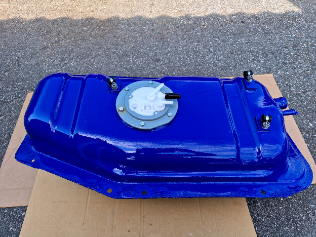

So with the painting done I decided to work on the tank. It was really bad. Very corroded around the seams. Initially I tried to sandblast it, but it didn't work very well. Whatever they had coated this with originally was very resistant, so it took 2 hours with stripping discs on the angle grinder to get most of it off. Really dirty job. Sandblasting took care of the rest, but also uncovered some holes around the smaller hose, I guess it's the vent line. At that time I more or less decided to go for a new one, but somewhat hard to get and expensive, at least to me. I googled fixing tanks and saw that soldering was an option, and since I had some thin copper plates in the garage I decided to give it a go since the tank was pristine, absolutely like new inside. That worked very well actually and I was really happy with the result. Hung it up with some gas in and no leaks after an hour. Replaced the fuel filter and pump also. I guess close to 25 years of service is enough. Also the straps that hold the fuel lines and the cable was gone, so I fastened some stainless bits on with epoxy and mounted some rubberized clamps on.

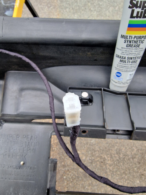

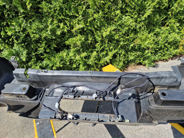

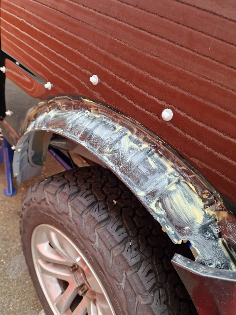

The rear fender was a real mess. Connectors more or less corroded off. Had to rewire most and source new connectors.
Spade connectors in an open connector. Seems pretty strange to me, but I filled them with dielectric grease.

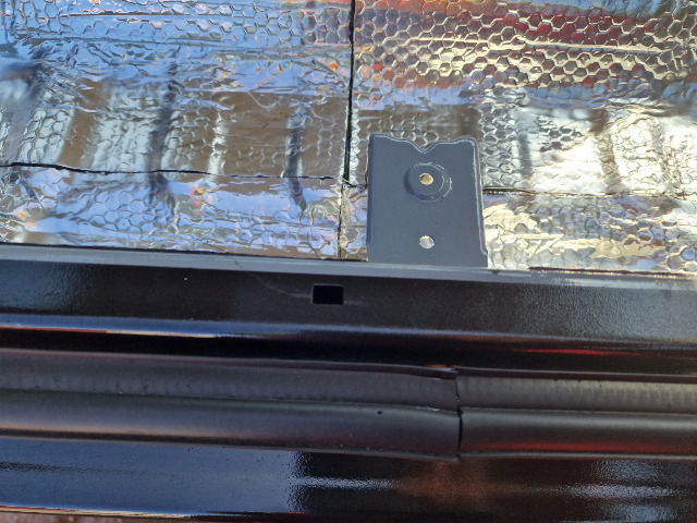

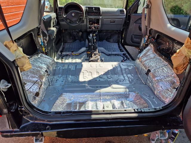

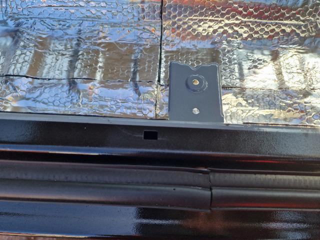

The floor is now done and got a coat of special rust preventive paint. Also put on some sound insulation. Don't know if it helps that much, but it didn't take that long.
The seal was torn some places so I found a universal one that fit really nice.

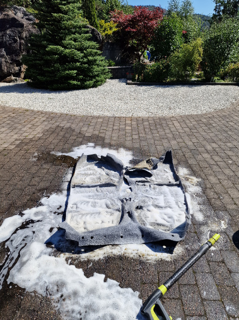

The interior carpet was nasty. I just soaked it in car soap and pressure washed it. Worked quite well. Somewhat worn, but clean.

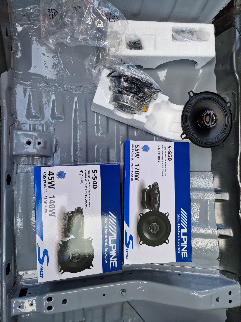

Decided to install some new speakers and radio. I read that 5-1/4" should fit in the back, but they did not. So had to make a couple of spacers that solved the problem. 4" fit well in the front. Also installed a Teyes CC3 2K headunit with a 9,5" touchscreen straight from AliExpress. Bought an adapter for the early Jimny, so it looks absolutely "OEM". Interesting stuff actually, came with Wifi, GPS antenna front and rear camera etc. Installed it and worked right away.

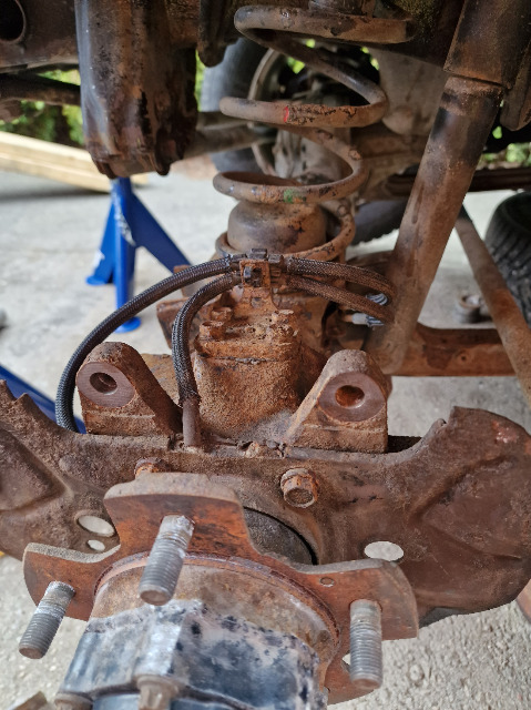

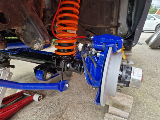

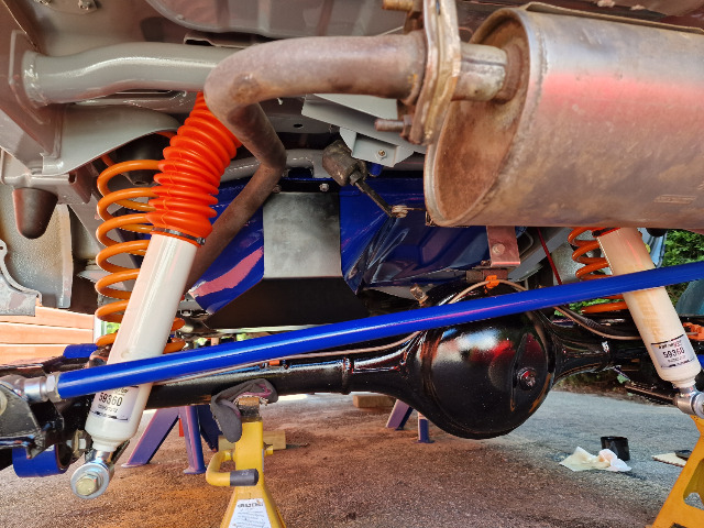

Had to do the needed things under the car. Put on a 2" Trailmaster kit, adjustable panhards, reinforced steering rods, did the calipers, all bushings, seals, bearings, new kingspins, drums, discs etc..etc. Also replaced the catalyst and the exhaust pipe just because I know a guy that ordered a set for his Toyota from Ebay and got a set for of all things, my Jimny! He was not happy and couldn't return it, so I got it cheap.
The front came with the patina of close to 25 years.
And after:

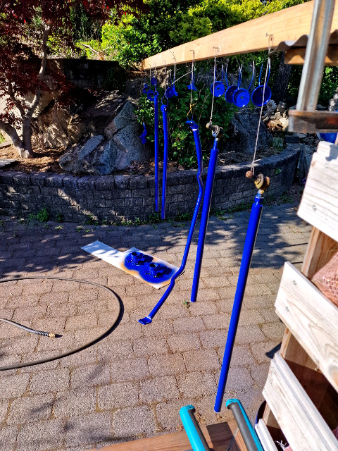

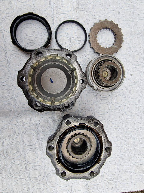

When I bought the car there was a box included with some new manual hubs. I put them on, but decided to give the old auto hubs a go.
So I took them off and gave the old ones some maintenance. Also blasted and painted all the lines for the vacuum system and replaced the rubbers.
The hubs clicks nicely.
Did the back.

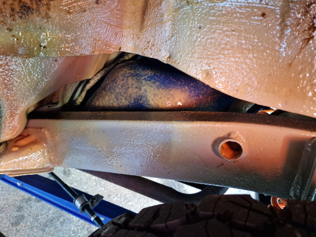

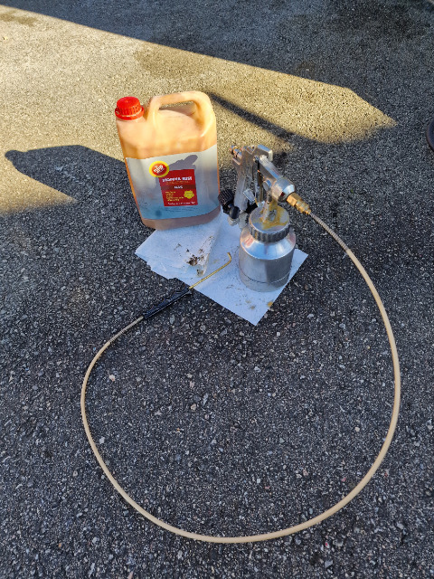

She shall not rust again, so we invested in some Fluid Film:
Fluid Film grease on the outside and on all exposed surfaces under the car:
I used 1 kg of grease and about 9 liters of Fluid Film, sprayed it liberally absolutely all over, inside and out. Likely too much. She smells really bad, and will likely drip for years, but I don't think she will rust again.
And after:

Did the back.
