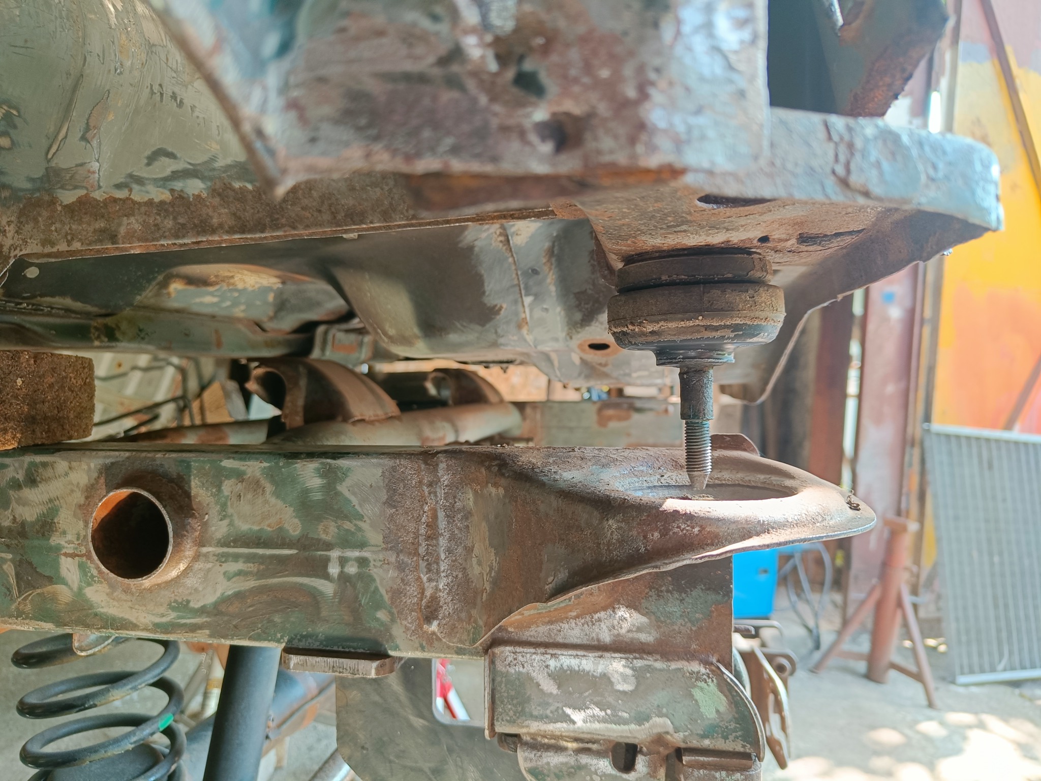

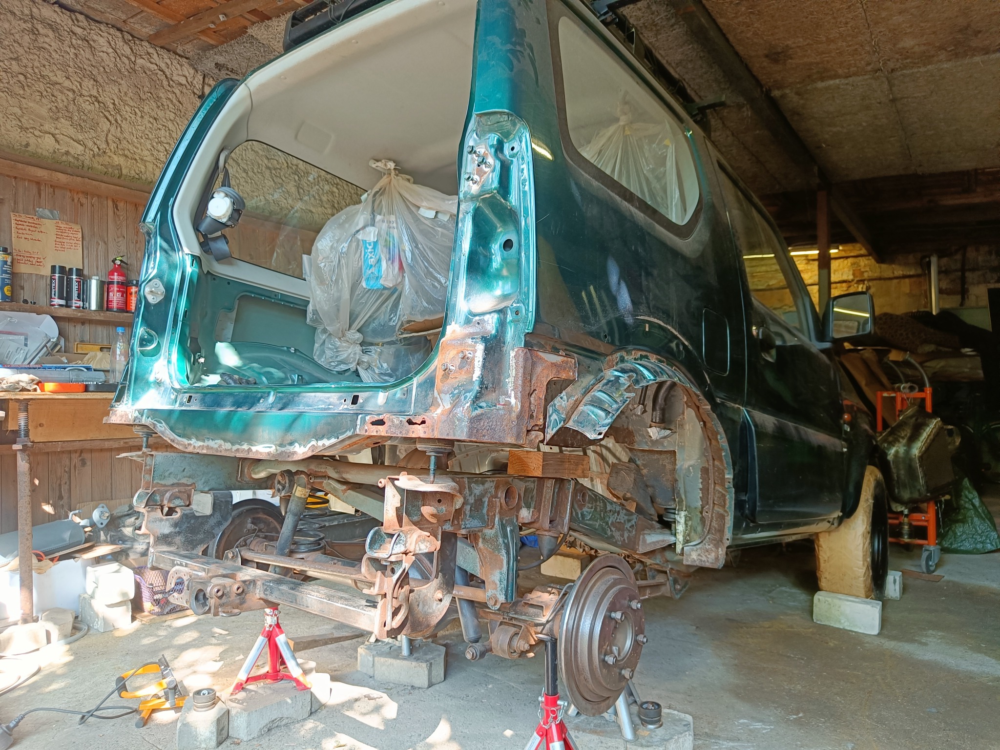

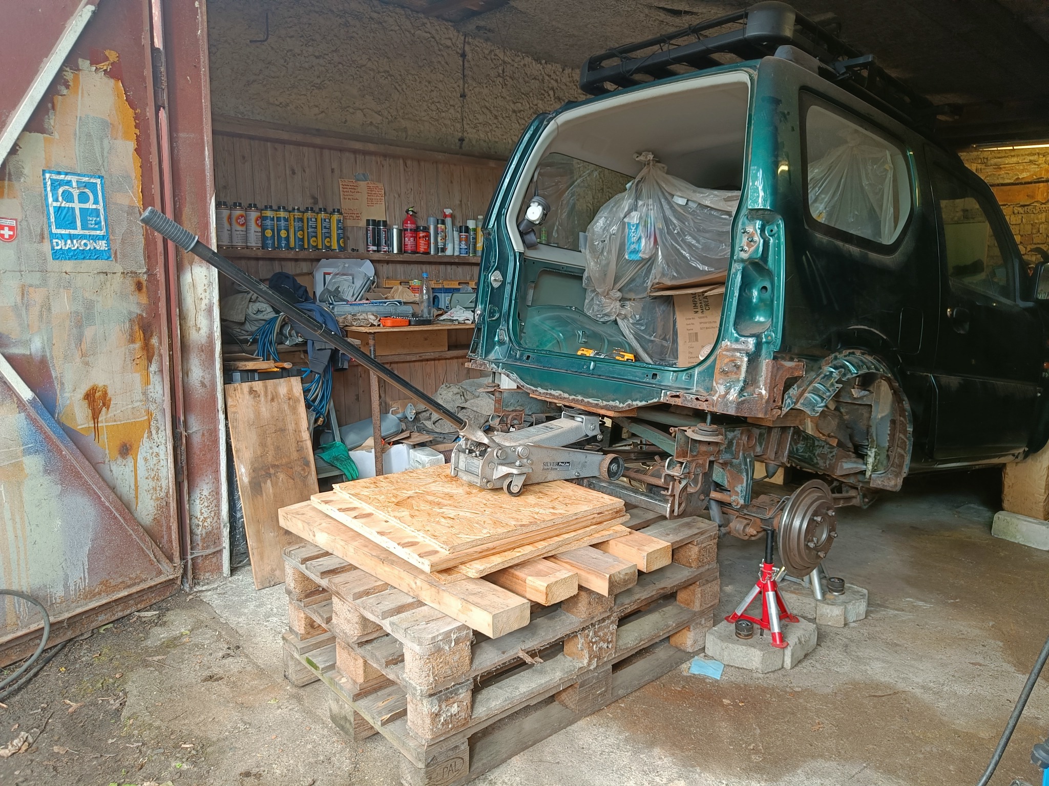

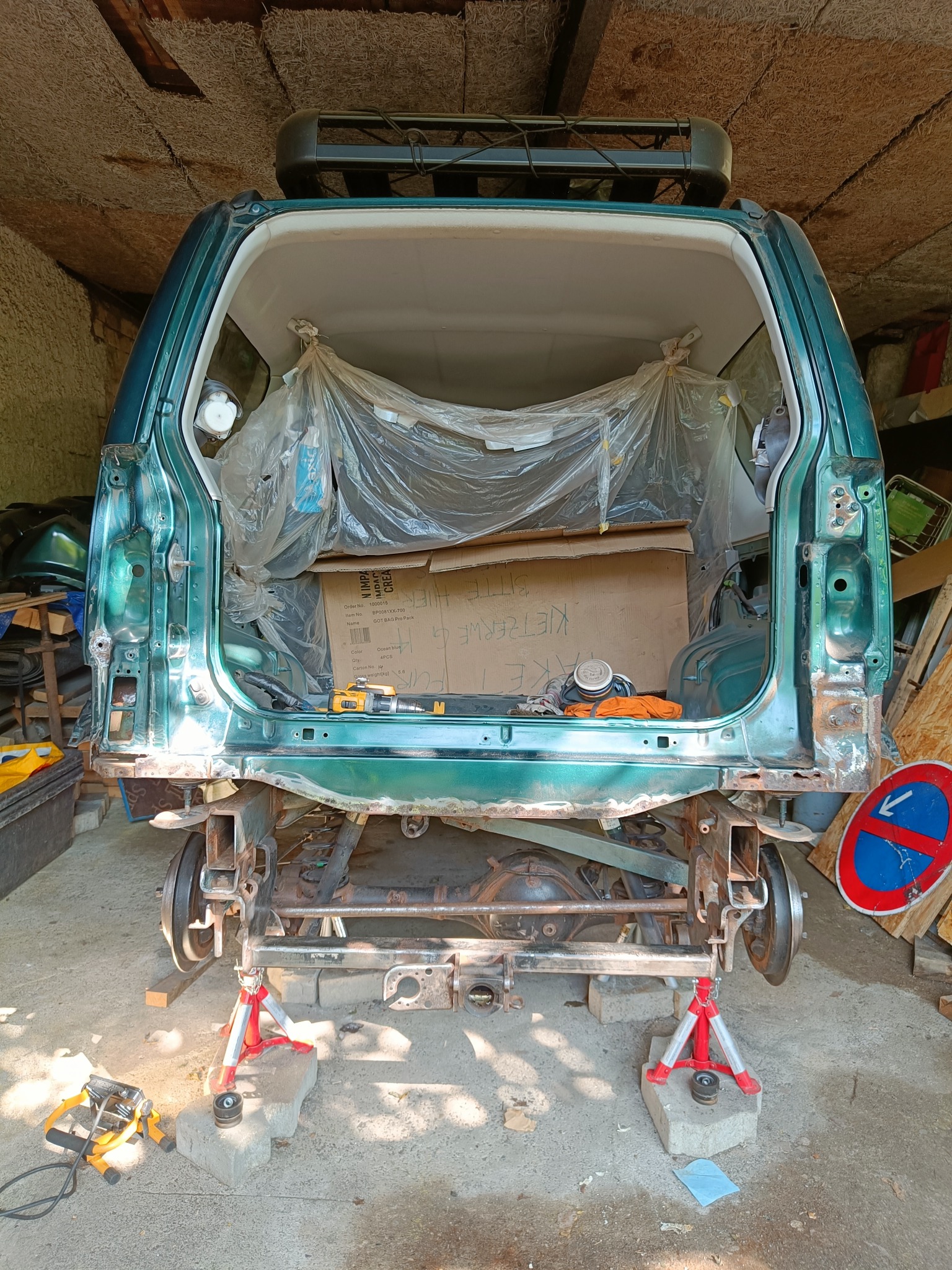

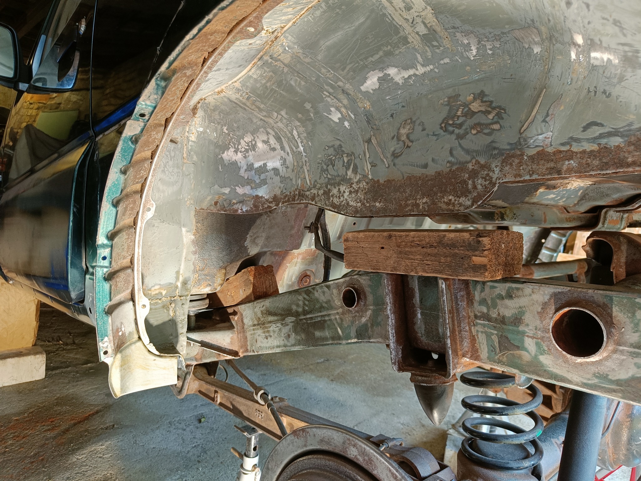

Decided to go with my initial approach which worked surprisingly smoothly.
Stacked 3 pallets in front of the rear of the car and then added some timber to get a platform that was level with the tow bar attachment. That way I could place the jack onto the tow bar whilst applying pressure and essentially prized apart the frame from chassis. Anyway here are few pics of current status.
