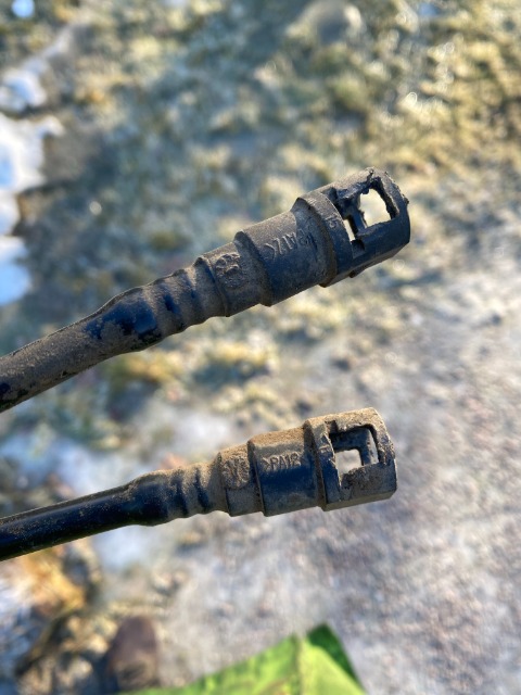

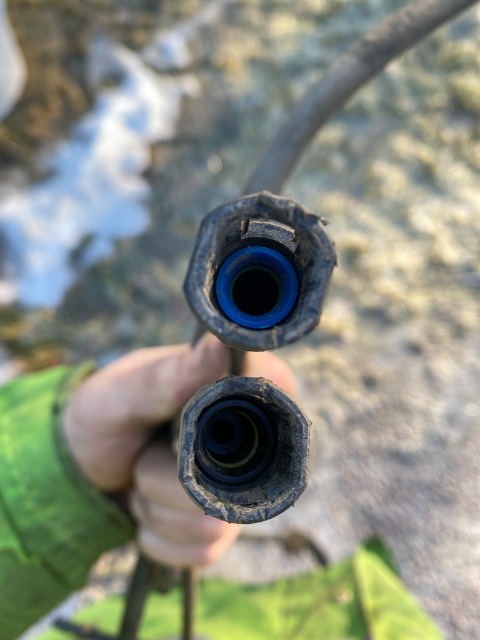

Hello,
My fuel lines started leaking - from above the tank. So now I have dropped the tank and removed the fuel lines but they use a special fitting that I do not know the name of.
Does anyone know what the fittings are called? Can I remake new lines with the current fittings, buy just new fittings or do I have to order completely new lines?

pics. of the pipes would be helpful.

Which pipes after you referring to?
Are you able to see the pictures I attached? I am trying to replacing all of the lines going from the fuel tank.
Edit: I am talking about part 8 & 9 from this exploded view here partsouq.com/en/catalog/genuine/unit?c=S...id=1624&uid=63649&q=
Part numbers are 15820-81A02 and 15860-81A02.

These bayonet style fittings may be to a basic fuel line spec. Search for "Movkzacv fuel line quick release coupler". I found the info. on Amazon. Data sheet gives dimensions so you can check with the tank fittings. About £8 each.
