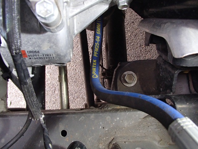

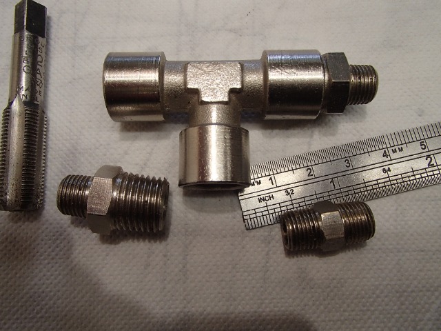

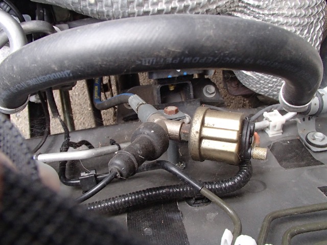

So you just screwed a line into the stock oil pressure sensor position and added the y piece with the stock and aftermarket sensors?
- Roger Fairclough
- Posts: 1465
- Thank you received: 217
23 Jan 2023 14:39 #247118
by Roger Fairclough
Replied by Roger Fairclough on topic Re:Re:Location for aftermarket oil pressure sensor?
Basically yes. The end you screw into the block needs to have a tapered thread at both ends, but the block end needs to be to suit the thread at that end. Mine was 1/8" gas thread but you can check yours with your hydraulic fittings supplier. The other end needs couplers that suit the "T" or "Y" piece that you buy. Use PTFE tape at all tapered thread joints and make certain that your hose is long enough to accommodate any engine movement.
