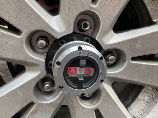

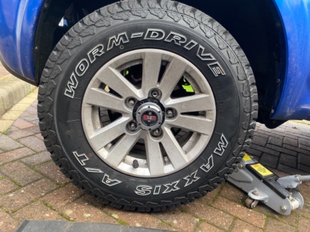

AVM manual hubs fitted this morning, all straight forward and easy to fit/operate. I blocked up the pipe so the pressure sensor works correctly.
Now we just need some snow or a bit of a muddy track.
Robin
