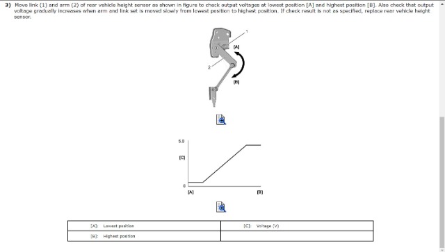

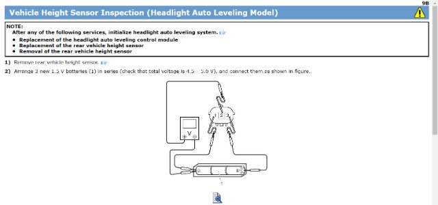

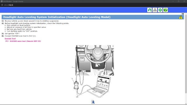

Replied by Soeley on topic Gen4 Headlight Auto Levelling Initiallisation
I think these are what you are after.
When you say it lowered the headlights too much when load was added to the rear, could it be the case that the headlight aim was just set too low even without any load in the rear, but was less noticable?

by GaSSiS
Replied by GaSSiS on topic Gen4 Headlight Auto Levelling Initiallisation
Thanks a lot for the instructions. At the end of that week I checked the correct operation of the auto-corrector by putting 4 people in the Jimny, and the headlights lowered correctly. But the headlights do not react to the loading of one or two people. Apparently, the fact is that the dealer's master was sitting in the car at the time of calibration, and therefore the car considered his weight as part of the weight of the car. I will try to come to the dealer again and ask to recalibrate with an empty cabin
11 Aug 2023 08:27 #250221
by GaSSiS
Finally, I once again drove to the official dealer. This time, they read the workshop manual themselves and admitted that they were wrong the first time by calibrating the sensor with the driver inside car. Recalibrated on an empty car. Everything is working fine now, thanks everyone
