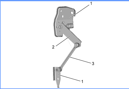

, I undid the Link (item 2 below)
As it did rattle when you moved it. When refitting, it slipped off the square spigot of the senor and it rotated a few times.

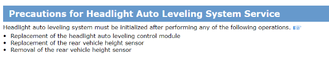

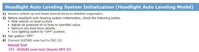

Now after finding the real cause of the rattle, I went out for a test drive, and as the headlights were set to Auto, I noticed they didn't do the usual up/down system check. So I decided to check the workshop manual, it says "After removing the link (Item 2 above) initialize headlight auto leveling system."
So this brings me on to my question, looking at the manual below, would this have to go to a Suzuki Main Dealer, or should any decent garage be able to do it? I'm guessing my cheap OBDII reader won't be able to do it?

I've only ever set them up with an SDT (or similar).
The sensor is a kinda variable resistor (like a Scalextric controller). The ecu that it gives info to needs to know where zero is. If you park on a level surface, set your tyre pressures etc. this is what the car considers to be zero. The ecu has picked up a loss of communication from the sensor and isnt sure where zero is now. Thats why you need to reset it.
I am sure some of the higher spec diagnostic machines can do it, Snap-on, Bosch etc. so if your local garage has one then it should be ok. They need to have access to the body control module and the 'Utility' function.
Have you phoned your local Suzuki dealer and asked for a quote? Resetting and recalibrating stuff is a pretty common job nowadays in dealerships, if you are clear on what you want them to do, I'm sure they wont be that expensive.
