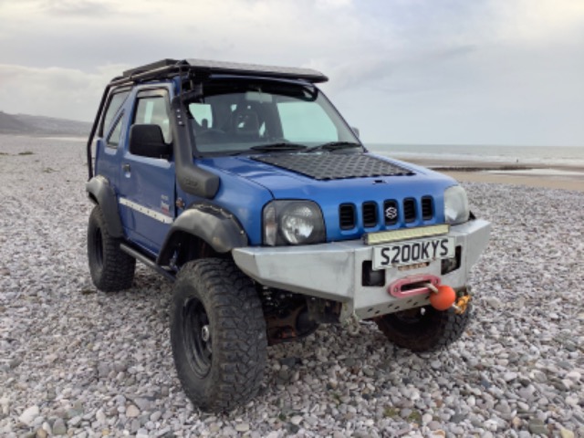

I had a near 5” lift on my old S200KYS Jimny (yes, James Lines - Martin’s son - now has the plate)…
JimnyBits Diesel front springs with 1.25” spring spacers on the front to handle all the weight of the bumpers, winch, etc… but it articulated really well off road… but on-road that translated to a lot of body roll in the corners and I’d hate to think what it would do at motorway speeds if I’d had to take evasive action…
An anti roll bar disconnect did the trick though, they are safe to run with just one of the (12mm) bolts fitted and are night and day when bolted up for road use…
Just my tuppence worth though…

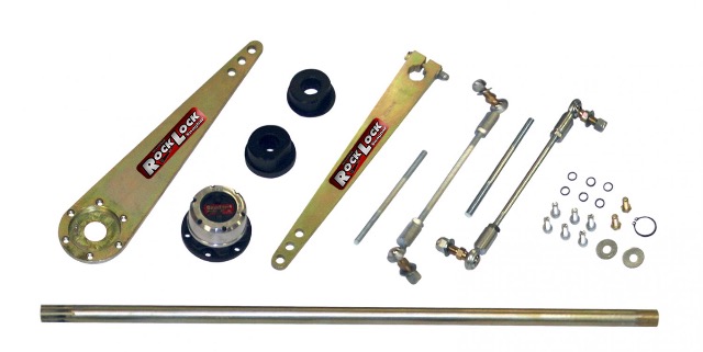

Lambert
I've seen your fab skills and bought a few bits off you from eBay. I like where you're going with the idea of your sway bay.
Here's one I like. (Bloody jeeps get all the good bits.)
skyjacker.com/shop/sway-bar-assembly/jfsba10/
Riccy
Any chance of a pic of your mate Gary's disconnect ?bsounds interesting.
Scimike
There are quite a few companies who do disconnectable/split drop links. Let me find some & I'll come back & edit/post links.

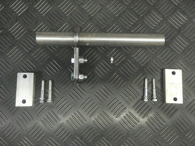

10 Apr 2022 16:04 #242834
While I would love to claim ownership of this I'm afraid it ain't me. I do have fabrication skills as that's what I did my apprenticeship as but I'm not doing I commercially just what I need for the shepherding.
Replied by Lambert on topic Re:Jimny Bits Swaybar (Anti Roll Bar) Quick Disconnect. Thoughts ?
Lambert
