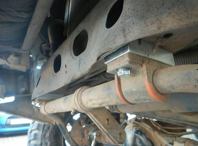

The blocks in Dave's kit are spacers
For where the bushes mount to the chassis
When you do a suspension lift it changes the angle of arb
So they help keep the factory angles

I usually list these in 6, 12, 25, and 38mm but am unable to ship due to being incarcerated in various hospitals…
(Nicely finished Aluminium spacers with matching longer bolts and spring washers - £14.95, £19.95, £24.95, £29.95 including UK shipping)
The photo above shows original JimnyBits ~6mm ones stacked with some of my 12mm ones… 6mm to clear the dislocating arms and 12mm on top for the lift as JOJ mentioned…
Replied by X8GGY on topic Re:Jimny Bits Swaybar (Anti Roll Bar) Quick Disconnect. Thoughts ?
