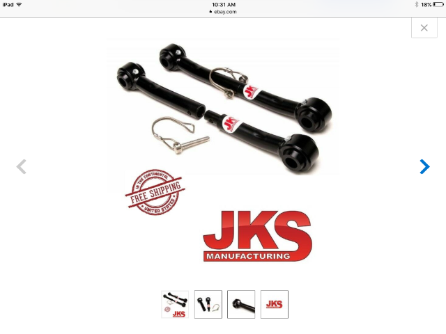

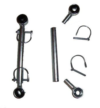

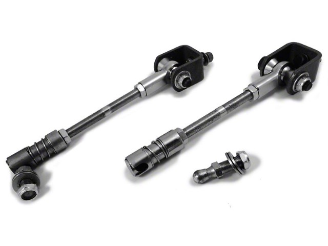

Alternate options. I wonder why JimnyBits didn't do cut end links like these few examples.
(If I ever get a complete ARB I'll look at replacing the Jimny bits one and getting some disconnecting end links that fit straight from the supplier or even getting some modified to fit mabe even completely fabed.)

Because they know their market, the shiny stuff like that is not going to sell as well as it might in the Jeep community because there's a perception that Jimny stuff is budget end not high end.

They wouldn't work on the Jimny. The Jimny drop links are very short and, with one removed, the end of the ARB passes very close to the droplink bracket (it may even hit the bracket, depending on how well your ARB is aligned in the chassis bushes.) You need to completely remove the drop link for it to work.

And therein probably lies the reason why Jimnybits did it the way they did.
Lambert
$59 for 2 steel tubes with 2 steel tabs welded to them ain't cheap. Makes those $120 jeep end liinks look like good value.
