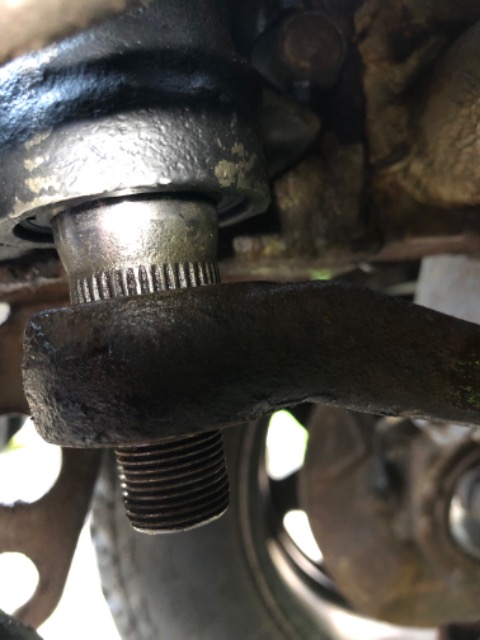

Can any of you kind folks tell me if this is ok ? I can’t get the pitman arm all the way up and I’m guessing it’s a taper. I can’t remember what it looked like when I took it off.
cheers

Tapered splines are normal. Take the Pitman Arm off and thoroughly clean the splines on the arm and the shaft. Refit and check that any sloppiness disappears as the arm reaches the limit as you push it on. There will be a lock washer and a nut to complete the job plus a whole load of torque. You must apply the torque without putting a load on the shaft.

Thanks Roger, that puts my mind at ease, hopefully I’ve not buggered anything when I done the bolt up.
