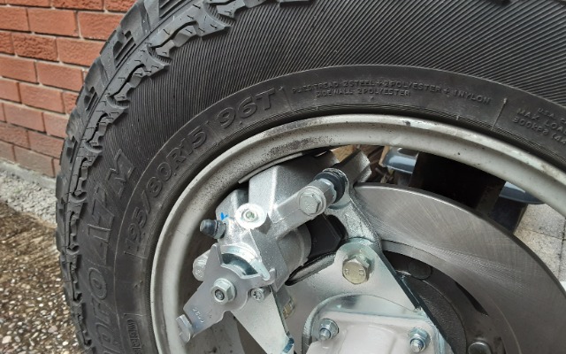

Replied by HUN on topic Disc conversion with standard wheels
Jimnybits disk conversion kit with Renault calipers is a tight fit on standard alloy wheels Calipers needed shaving and balancing weights had to be changed to a different type in my case.
Photos taken when I realised this.

I I’ve the 3 spoke special wheels aslong as it’s like your should be fine. May look at upgrading wheel size to 16?
