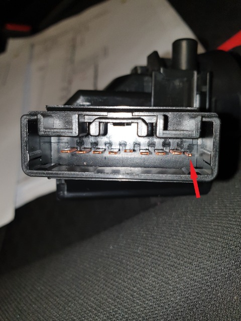

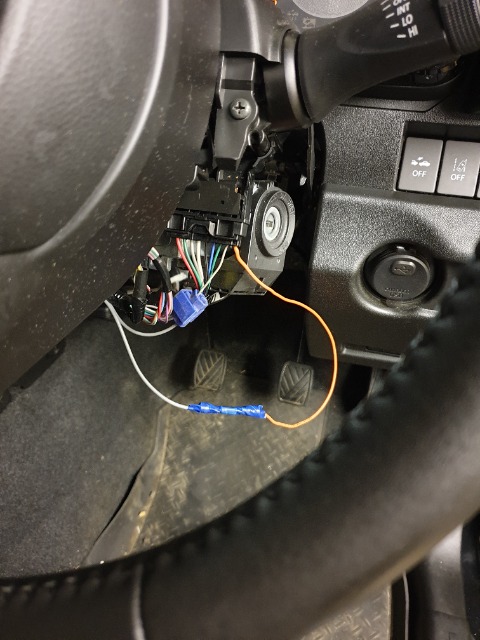

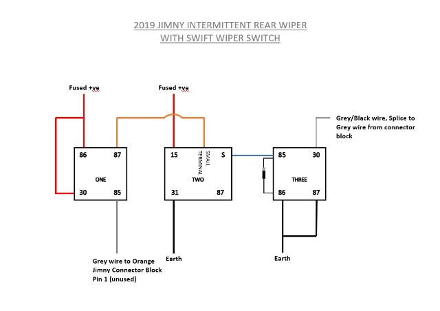

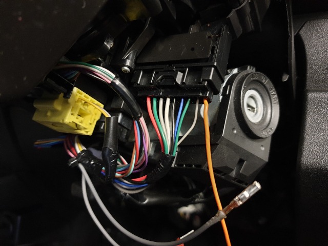

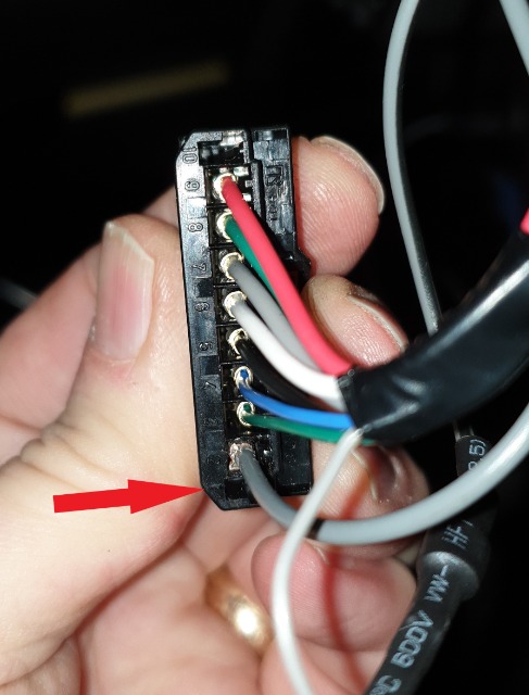

Update time,
I have (thanks to Martin for pointing it out to me) reconfiguerd the way the realy circuit connects to the Jimny.
Now this is only if you have the later Swift style switch fitted with the INT position on the Rear Wiper.
The original Grey wire I had removed from the block is now put back into position, the output wire from Realy 3, #30 is now spliced into this.
The switch has an unused pin, #1 (zoom in, you can just see the numbers)
Corresponding hole in the connector block
Flylead with small terminal fitted into the hole. I opened it up with a 3mm drill the went down it with a small square needle file.
Connected up to the Relay circuit, Relay 1, #85
And the final diagram tweaked to show the update
Finaly a video of it in operation
