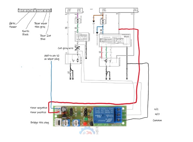

Here is my method of adding an intermittent function with a swift stalk, note I am in Australia and our stalk is on the left of the column, it seems the pin numbers are backwards, but not colours.
Basics of it are a timer module that you can vary the on time and off time, off time is the delay between wipes and on time only needs to be very short, about .2 of a second to get the wiper moving and then the self park feature will take over.
You can power your timer from the thick grey wire, this has power when ignition is on, for the earth we will feed it via the rear int switch in the Swift stalk, this switches to earth when turned on, for that a pin needs to be added into the plug in position 10 (nothing there in a Jimny) So that makes our timer turn on when needed, all other times it does nothing.
To make things happen, we need to pulse the rear wiper motor control wire (thin grey) to earth to get it to do a sweep, to do this we will cut the wire and loop it through the changeover relay on the timer, with the common terminal hooked up to the motor side of the wire we cut and the stalk side to the normally closed side, then we will connect the normally open terminal to the black earth wire. So when the timer is doing nothing, the thin grey wire passes through the relay so none of the wash and wipe or on functions are interrupted and then when the timer is engaged, it pulses the relay to earth.
If this makes sense to you then finding a timer you like should be easy, the extra terminal you need to add is a bit of a hard one, It's a Sumitomo HE060 uninsulated terminal which seems to be available genuine only which means buy 50000 or get reamed, but look around and you might find something.
I make and sell these ready to go along with the HE060 terminal crimped on a wire, in Australia. I could look at adapting them to fit a UK car but I don't see if being economical, verse creating your own.
