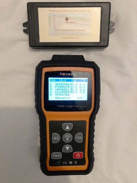

mlines wrote: As they emulate the sensors, they are specific to the sensor/receiver set-up which in the case of Suzuki is from Continental Tyres. Therefore the emulator emulates the Continental  Sensors.
I have one here on loan for a member (no, I have not forgotten I have to return it, David). It is from IronGates.
Here you can see it transmitting random sensor information.
Thanks, these are completely new on me. So I feel like I have learned something today! :D
Don't suppose you know how easy they are to buy or what kind of price they might be?

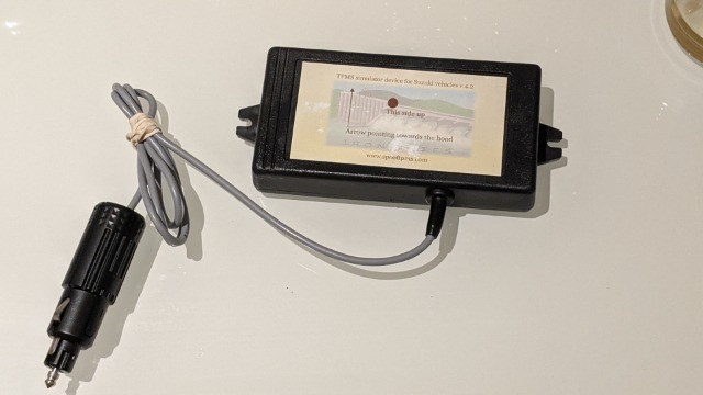

13 Jan 2021 05:30 #231760 by Lambert
This is one option as used by forum members
spooftpms.com/
The following user(s) said Thank You: 300bhpton
13 Jan 2021 07:08 - 13 Jan 2021 07:10 #231761 by mlines
Lambert wrote: This is one option as used by forum members
spooftpms.com/
That's the one I have been loaned by a forum member. The tpms on a Jimny seems quite flaky when compared to the identical system on the swift. I assume it is due to blocking of the radio signal by the wheels or the body work. He could not get the tpms spoofer to work and the company sent him another. After lots of messing around we got both working.
