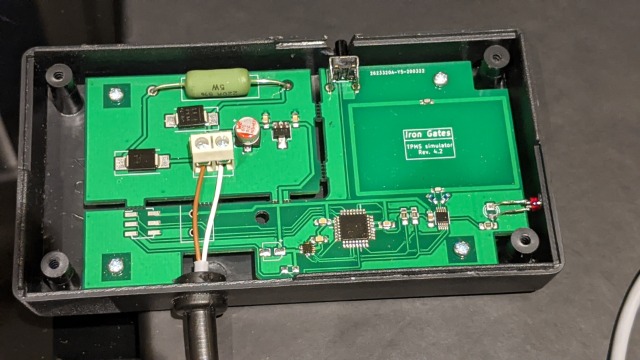

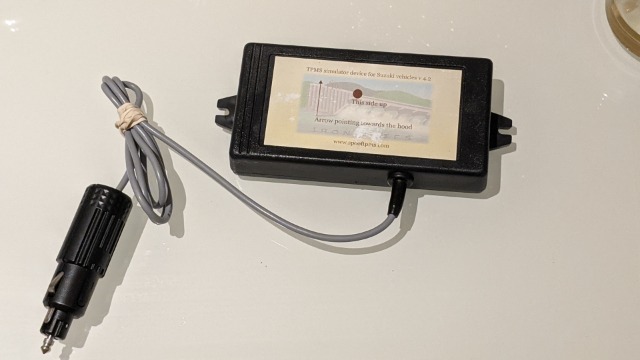

Replied by mlines on topic Re:Tyre Pressure on Gen4 w BFG K02 - still a bit confused
As they emulate the sensors, they are specific to the sensor/receiver set-up which in the case of Suzuki is from Continental Tyres. Therefore the emulator emulates the Continental Sensors.
I have one here on loan for a member (no, I have not forgotten I have to return it, David). It is from IronGates.
Here you can see it transmitting random sensor information.

So does the use of this emulator require the TPMS sensors to be removed from the wheels or will it override the existing sensor signals ?
12 Jan 2021 20:48 #231753
Sensors have to be removed otherwise the Jimny system has eight "sensors" to choose from when learning the sensors (which it does every time it has been stopped for more than 20 minutes)
