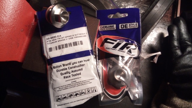

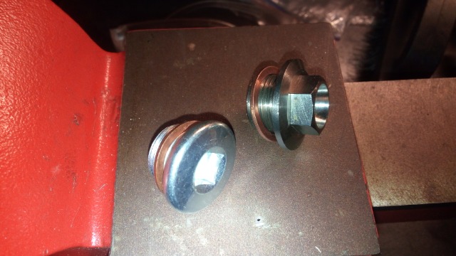

And the 'proper' filler plug is not a factory one but rather something like the one on the right.
No more welding a nut for me.
