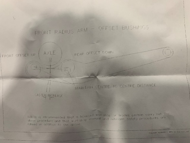

I haven't gotten around to fitting my bushes yet, but these are the instructions.
I have also read that before you remove the radius arms to mark the top of the bush housing to help orientate the offset bushes when fitting.

The thing is that even a small variation will affect drastically the caster angle.
I even took a picture from a youtube video.
Sent from my SM-G975F using Tapatalk
Replied by wicho001 on topic Re:Jimny jb74 pulling to the left
Correct, that's what I did.Soeley wrote: I haven't gotten around to fitting my bushes yet, but these are the instructions.
