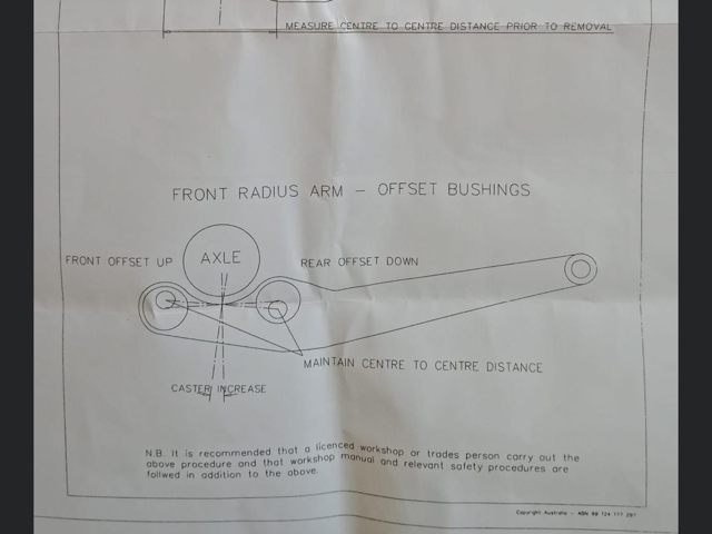

Grim Reaper wrote: Having just fitted the OME offset bushes today, unless they have got the bushes in upside down (ie the hole at the bottom on the front bush rather than at the top and at the top on the rear bush rather than at the bottom) then there is no way they can be in the wrong position unless the rear bush has been changed for an adjustable one as well.
The way the new bushes are held by the three bolts being in a triangle means they have to be in the right place, the rear bush being fixed means the front bushes can’t rotate as there is no allowance for movement, the rear bush keeps the triangle stable.
Thanks for your reply mate.
I know for sure they are fitted the correct way but maybe one side is not identical to the other causing a weir angle in one side of the axle. I hope that is the case because I don't know what else could it be.
Sent from my SM-G975F using Tapatalk
16 Aug 2020 04:03 #226762 by Grim Reaper
Measure front to rear wheel centres on each side, they should be the same, if not, slacken the four pinch bolts for the front bushings and correct the difference so both sides are the same then tighten the pinch bolts back up.
  • wicho001
26 Aug 2020 19:50 #227381 by wicho001
Replied by wicho001 on topic Re:Jimny jb74 pulling to the left
Update:
Car is fixed. The problem was a caster correction bushes install. Put one arm on top of the other and adjusted the angel so both arms where identical.
Thanks for all the help guys.
