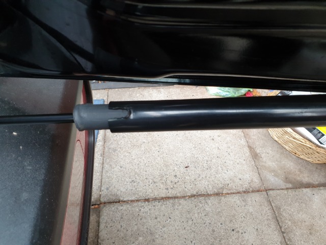

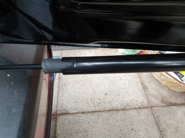

6 years 3 months ago - 6 years 3 months ago #225276 by Soeley
Replied by Soeley on topic Tailgate strut
Here is my DIY strut lock. Made from 25mm plastic conduit. Keyhole cut in the end that pushes over the ball mount, to hold it in place. I hot glued a washer to the end of the tube and put shrink sleeve over for a bit of protection. The shrink sleeve also gives a bit of friction, just enough to stop the conduit sliding about round corners. When rear door is open, just give it a slight nudge to allow the lock to drop into place.

6 years 3 months ago - 6 years 3 months ago #225284 by DAGZOOK
Replied by DAGZOOK on topic Tailgate strut
Nicely done Soeley! great work as always. That actually works in exactly the same manner as the one I received from SGS (All be it defective). It slid over the rod end of the strut, it had a 15mm thick collar that was held in place by the ball joint which screwed onto the M6 rod thread. It was the thickness of this collar that affected the struts compressed length!
I've complained that SGS don't mention the compensation required when offering the safety lock tube as an option of their configurator tool.
I watched an autocar review recently on YouTube (I think it was the new landcruiser?) the rear boot strut locked with a simple quarter turn? must have been an adjustable valve or something within the strut. Very neat idea!
*EDIT* found the video I was talking about. Scroll to 2.00minutes, this is the kind of locking strut I'm looking for. May try and find out the specs for that part!

6 years 3 months ago #225293 by Soeley
That's quite neat!
As a side note, I have just bought the wife a Ford Ecosport (side opening rear door) when you oper the rear door it only opens about a third of the way, give it another push and it opens all the way. I have got as far as measuring the strut and it is longer (can't remember the number now). I do intent to try it on the Jimny to see how it works out. I think a two stage opener will be quite useful at times.
