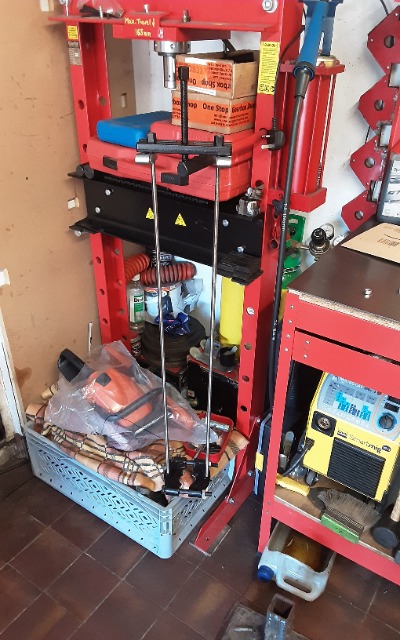

HUN wrote: Thanks Scimike, I bet it was not the last!
I'm wondering how often I will need to do it as this particular bearing was replaced 3 years ago and the car has run only 8K miles ish since. :S Most of it's journey was 70 mph on motorways with only 300 miles heavy off-road. No other wheel bearing has been replaced since I bought it in 2015 (I've driven only 22K miles).
Altough I managed to get them off carefully I've seen signs of careless use of angle grinder... :angry: two cuts on the shaft made by someone else before me. Unfortunately one of them 1.6mm deep! :sick:
I found cutting the bearing was more difficult than ABS ring therefore I'm planning to pull the bearing off next time. Ordered two 36" long 3/8"UNC threaded bars which hopefully will work nicely with my 20t press B) . New bearing went in place with not much effort really. But the ABS ring is a different beast. It has to be cut off every time, no other alternatives..:unsure: New one gradually moved and took an increasing load of pressure every time I managed to slide. Last push was 9t when it went to it's final place! :pinch: Perhaps I should have heat up before?!? Axle shaft will worn out if this happens too often! :dry:

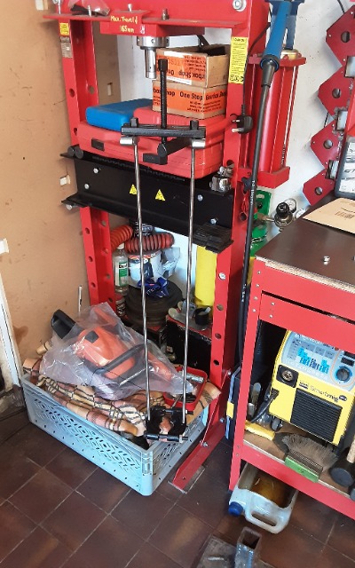

UNC 3/8" threaded bars have arrived this morning. :woohoo:
No more wheel bearing grinding!

This won't work. Pushed two off the other day 10 ton for one. 15 ton on the other. Also it has badly scored up the abs retainer and slightly scored the shaft. If you want to reuse the abs retainer they will need to be made a loser fit, possibly use lock tight to hold in place as this holds the bearing there.
