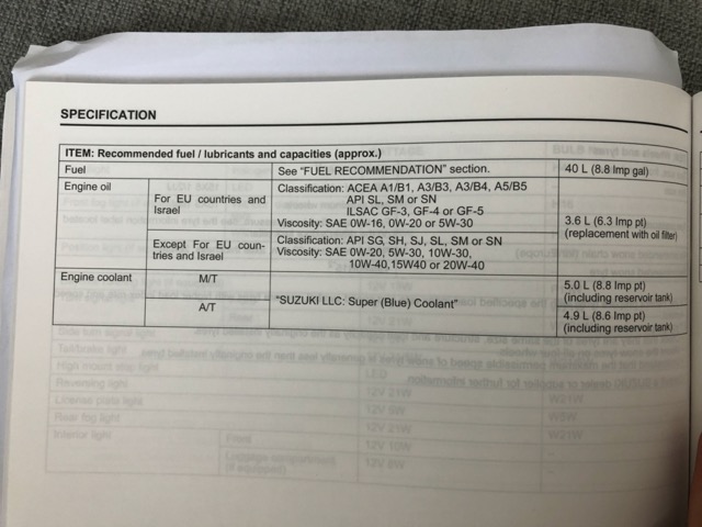

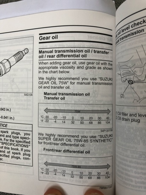

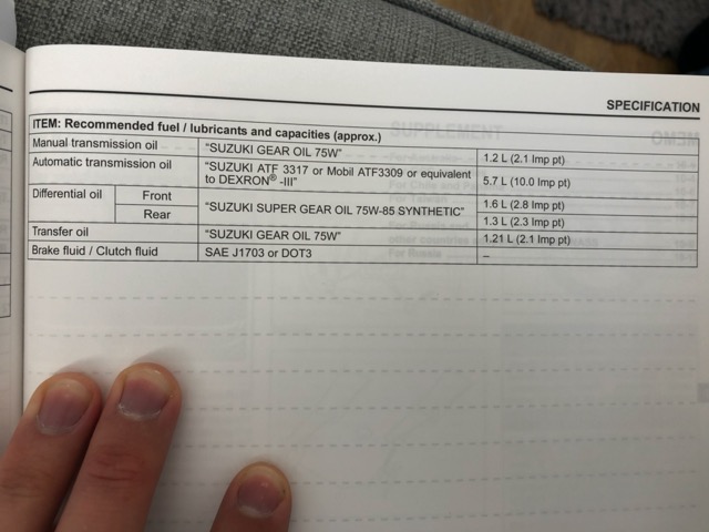

I've got the Gen. 4 service manual in front of me and it's as clear as mud. Have you found a statement that specifically states GL4 or GL5? I can only see this wooly statement: (My 20 year old BMW has the Oil type stamped onto the bottom of the gearbox & diff's that's the germans for you.....)

Just found this:
Ambiguous Japs. I would personally choose a GL4 for the gearbox & transfer box as and when they need a fluid change and GL5 for the front and rear Differentials.
Differential Oil:
(I wouldn't be concerned at all about the difference between 75w 85/90 This is a really standard grade high quality Diff Oil used across the industry - Suzuki seem to specify very unusual viscosities - much like their 0w 16 engine oil which hasn't caught on in the UK yet... purely in place due to EU emissions regulations. Note that all countries outside the EU utilise NORMAL grade engine oil for the same engine :whistle: )

Thanks both. Not sure where I got the GL4 from, but can't find any reference to it now, so will probably go with GL5. This stuff seems to fit the bill and won't bankrupt me for the 3litres needed!
