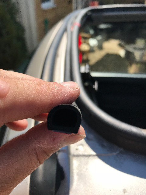

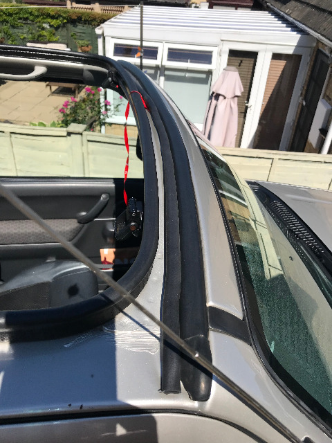

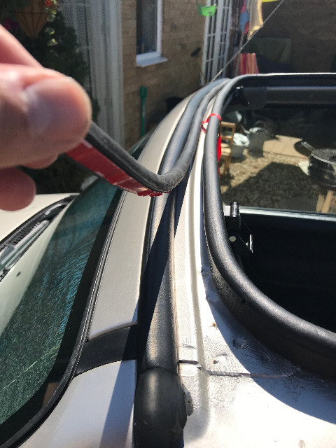

Perhaps as an emergency measure you could determine the gap, and bond some rubber extrusion around the roof apperture, underneath the targa, such as THIS ONE along the areas you think the water is getting in. Or, belt-and-braces all the way around the targa. If you do this - dont completely rely on the self-adhesive bit - I found it wasn't that great.
Failing that see if there is any larger- section seal available that goes around the lip of the roof apperture. In an attempt to make it a tighter fit against the targa roof.
I did exactly this along the front-edge of my targa - not to stop leaks but in an attempt to quieten down some of the wind-noise.

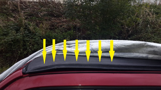

As you can see from the attached photos, the main problem is that the side doesn't fit flush with the roof structure - it is the same on the other side but not nearly as bad. This allows water to get blown in (I think) which then runs down the front channel and drips down the windscreen. You can see the water stains on the inside of the roof over the passenger door. When I fitted the first bar and the original leaking happened I actually drove my car from Wales to Monsoon's workshop (near Eastbourne!) for them to look at and they agreed to make me a new one, checking their 'jig' and fitting it on a Jimny they said they had in the workshop at the time. Several weeks (and some nagging!) later they finally sent me the new one which is just as bad, if not worse, than the original - which is incredibly disappointing. Sadly I binned the metal one so that isn't an option, and yes, I am kicking myself! I've tried looking online for a second hand one but no luck

I've shown the husband your photos and he says he can try that but do it all the way round the roof opening. We also thought we might be able to glue velcro onto the bodywork and canvas and close the gap like that? It may not look great but might be functional which is the main thing I suppose

Wow yes, I see the problem! It's very clear that there is a huge gap where I've marked with arrows on your photo
Some questions about the fibreglass frame as I've never seen one:
Are the fibreglass sidearms straight when not fitted to the car or are they formed with that curve?
How flexible are the side arms?
It looks as if there could be too much tension in the fabric from front to back causing the arms to bow at the point I've marked with arrows - the original metal arms are just plain straight tubes.
How long are the side arms compared to the original frame?
Unfortunately we don't have a direct comparison as the old frame got filed under B1n, but I'm wondering if its because they are too long and under compression, and its that causing them to bow.

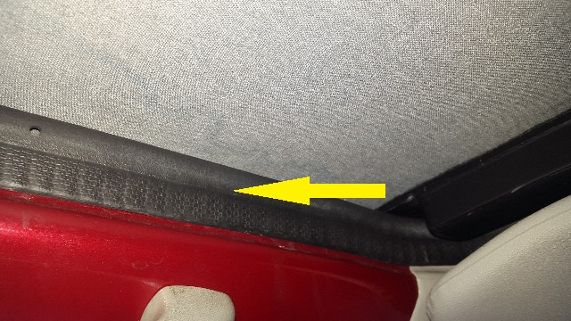

I seem to recall on mine (its dark outside or I would go and inspect it now) there is some sort of white nylon or plastic "plate" thing in the fabric cover near the front corners - has that got misaligned and somehow causing the apparent gap?
(mine is not as good on the drivers side for some reason and I do have a small gap slightly like yours, but nowhere near as long, and certainly not to the extent that it leaks - and I live in the Cotswold hills where it rains sideways!)
I have arrowed the seal that I mentioned that goes all around the aperture. That should be making good firm contact with the targa covering, all the way around the roof aperture. Is yours?
