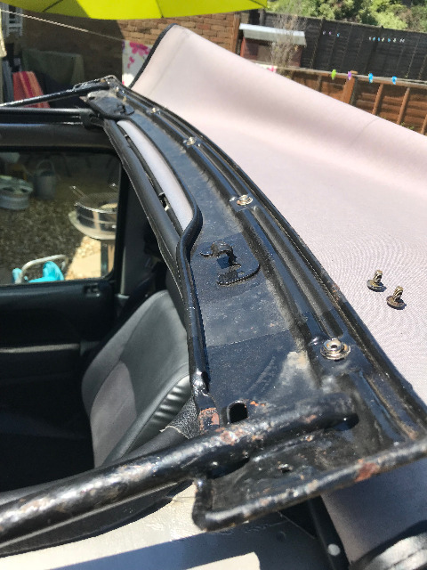

Its not a clear photo - but this is how my side-arms "land" on the header-bar - they remain straight. Simply welded on
There appears to be a bend in the Monsoon one at the point the tube is flattened. Of course, there may be a reason for that, that I'm not aware of, but it looks wrong.

Yes - I totally agree; I think that would really show where the problem actually is.

I can see what you mean from the photos, it does look wrong and would introduce the side lift you can see if the fabric is resting on the arms.
I would go for bending to make it fit better, but as you say you need to grip the tube to prevent the rivets / fiberglass failing. Again this assumes there is no obvious reason for the difference that we can't see in the photos.
